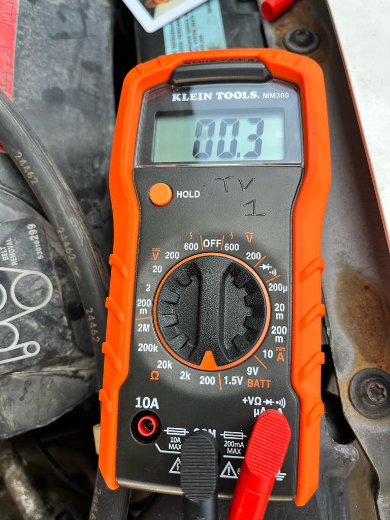

I just put a meter on the alternator line with the fusible link and have continuity. See photo.

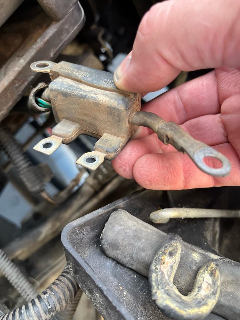

Does anyone know if this piece that attaches to the two small terminals of the alternator are a sort of fuse that may be the issue?

Looking through my 1997 service manual, I think the piece with two terminals is just a connector - nothing special. The terminals are called "field terminals" and one should be 12v constant, and the other one varies.
