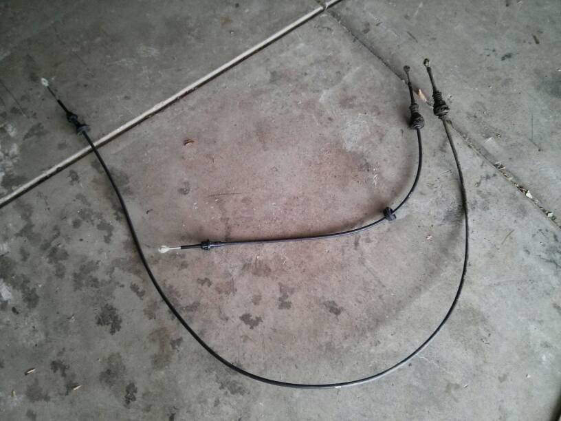

So, I looked up the specs for my Jeep (a '95) and it said it should be 55" long and it looked like there were two different lengths with the 55" one being substantially shorter than the other. So, I pull my cable off and measure it and it doesn't even come up to the 55" it's supposed to be! Mine only measured 44" and I wasn't having much luck rerouting it.
My friend was parting out a '90, which is supposed to bre the long cable. So, I went over and pulled the cable off the parts Jeep. Well, this cable was routed a totally different, passing through there is over by the fuse panel. Mine went through right about in front of the shifter. After getting his out and comparing the two, I have no doubt that I will have enough room to make this work!
For anybody looking to relocate their AW4 shifter, the Renix cable is DEFINITELY the one you want!! Check out the difference!!
