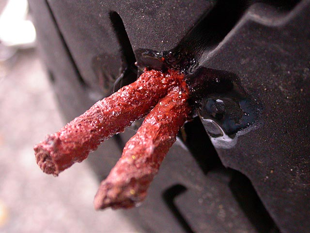

NEVER NEVER NEVER...........maybe not made my point........NEVER use fix a flat.........for any reason...........use plug kit etc. DID I mention never use fix a flat LOL

If you leaking around the rim, fix a flat prolly won't fix it either. Either get the crap out from between the wheel and tire or straiten out your wheel.
With a plug you don't need to break the tire down.

Like I said tire plugs.........If you cant fix your own tires on the trail you should nto be on the trail as far as Im concerned.........buy a good tire plug kit........

most shops will now charge 10 to 20 extra now for cleaning the junk out of your tire /wheel.....also it gums up the valve stems and causes slow leaks.....using the correct plug to patch the tire....will do the dame thing as the tire shop will do in many cases.........if it is a large hole the will remove the tire from the rim and vulcanize on the inside, most times they will only use a plug and snip of the excess

What are you saying? Fix a flat is the right way? I trust a plug over fix a flat anyday.
