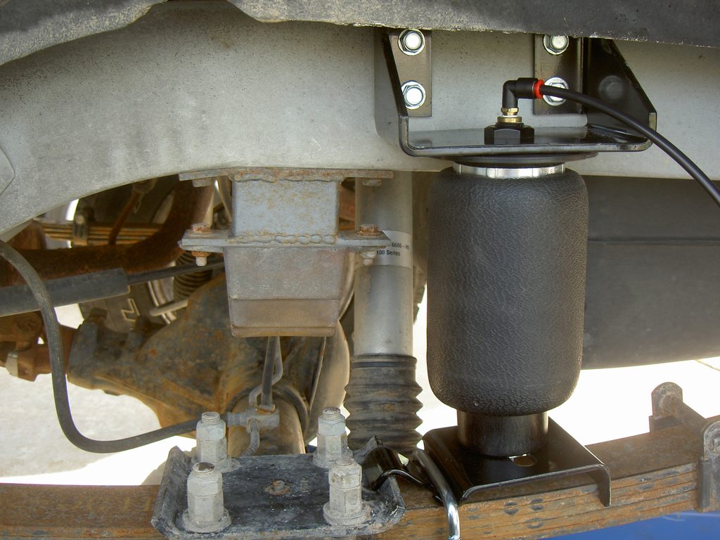

Overall the install is easy. I did flip the upper mounts upside down to help compensate for the lift. I took this into account when I ordered everything. This has been documented by other rigs I have found out there, so nothing ground breaking there. I think getting the airlines routed (and drilling the mounts to allow me to go thru them) took as long as the actual bag install.

Using the guide to set the mounts into the right spot
Airing up to see if everything is clear of the bag
Airline routed and put into wire loom, wrapped with tape. Still need to get a clamp to hold the line. I had every size but the one I needed. Also added the supplied heat shield but am going to get the rear exhaust pipe rerouted for more clearance.

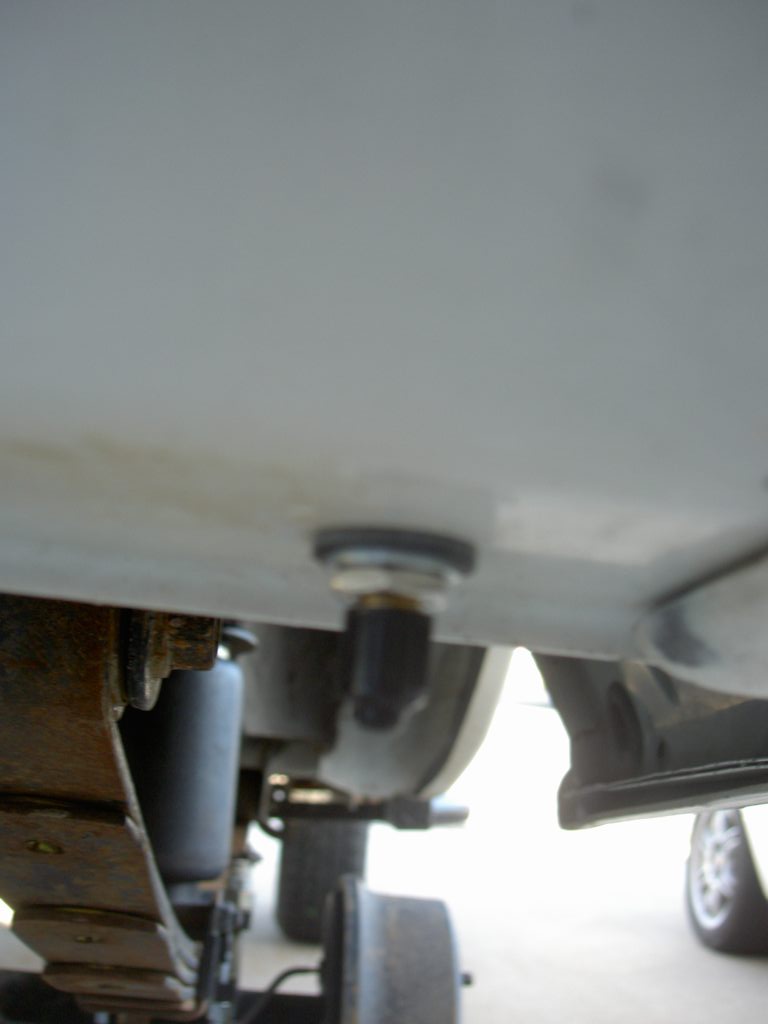

Fill valve in bottom corner of the bumper. Enlarged a hole already there that allowed routing the line thru some brackets.

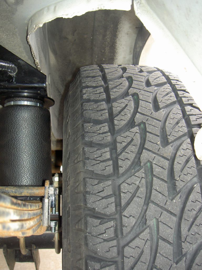

I am not sure why the stock 16" wheels and 245/75-16 tires will be any issue. If I can rub the bags with them, I got some other serious issues like a broken spring.

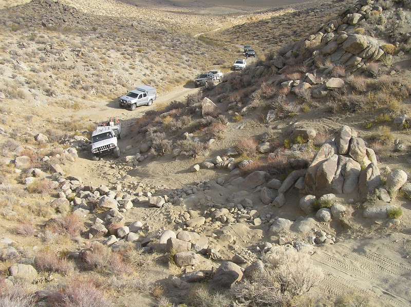

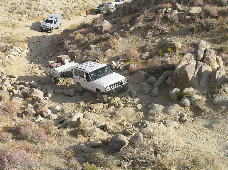

For those who don't know what trailer I am towing, our Kamparoo is not a "mall crawler" trailer nor do we use it as such. Here are a couple pics from Mengel Pass (going up it) in Death Valley.
BTW, we were the only trailer in the group to walk up this without any issue. We actually made it up easier than some of the other rigs. YMMV :D

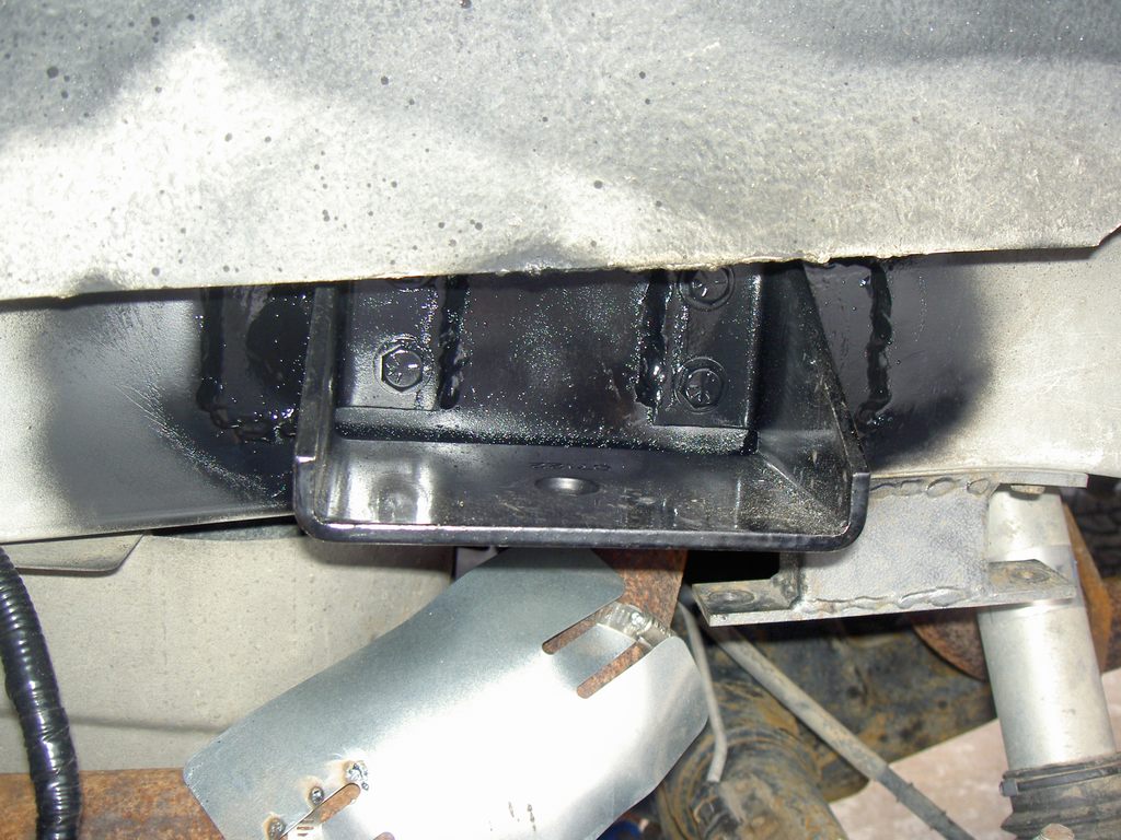

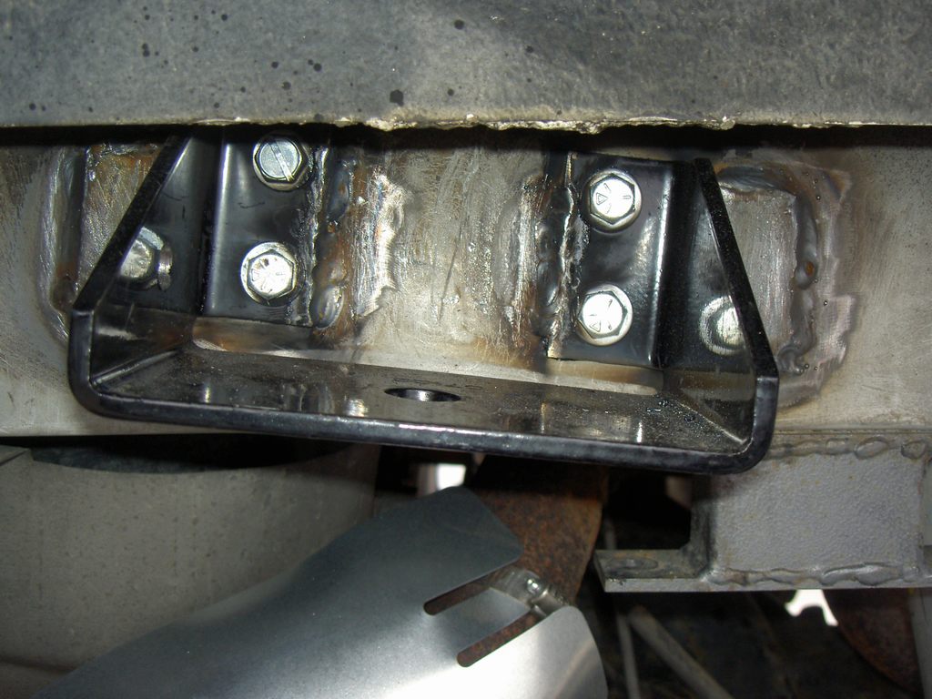

Wanted to do a follow up post. After driving on them for a day, I was starting to hear a sound from the driver side, that sounded like the bracket was starting to loosen up. Since that side only uses 1 thru bolt and 3 self tapping bolts, I decided to just weld the brackets to the subframe. I made some extension pieces for the outside of the brackets, to help distribute the load more. Got them welded on and I don't think they are going anywhere now. :D

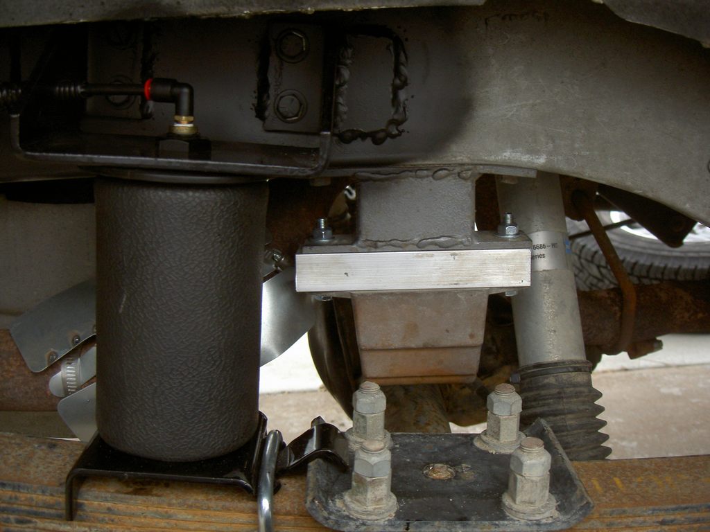

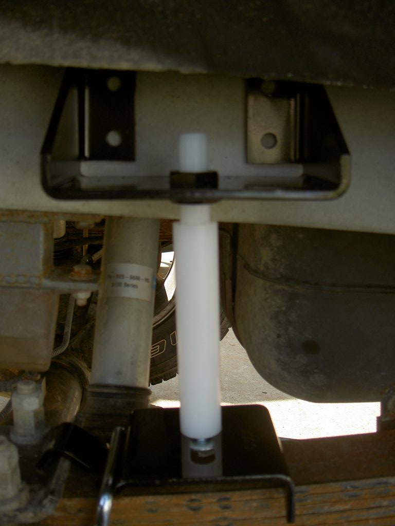

I also made my 1" spacers for the bumpstops. Just aluminum stock but should do the trick. Should be set now.
Pic showing tire clearance (245/75-16 on stock 16x7 wheels)
Brackets welded on with outer extensions
With some paint
Bumpstop spacers made
