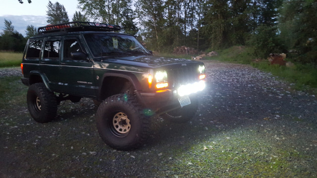

I installed some predator headlights...AWESOME!. I'm very happy with their performance. And 2 more Hella fogs.

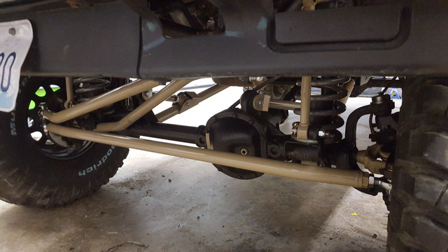

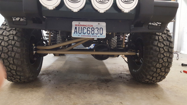

Cavfab one ton steering

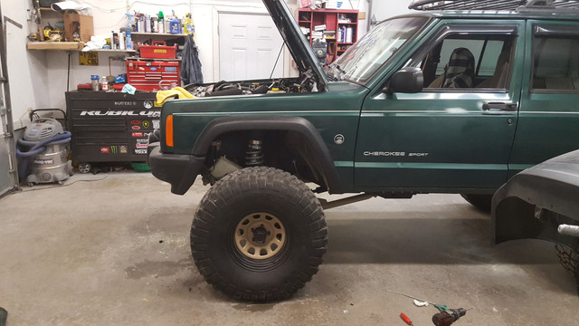

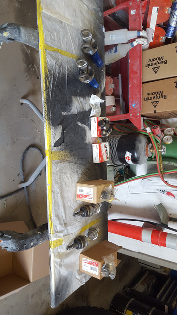

Installed Spicer ball joints, stubs, and u joints. Kit on amazon 258 bucks.

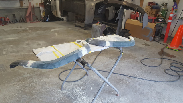

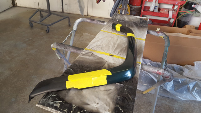

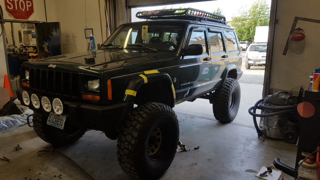

Made my front fender flares out of my originals and a pair of aftermarket ones. I have enough material for the rears leftover. I'm about 50 bucks into em.

best free photo hostingInstalled Spicer ball joints, stubs, and u joints. Kit on amazon 258 bucks. Even painted my stubs.

I used my original set, and a set of aftermarket ones. I strategically hacked them up and fused and reinforced the pieces back together on the back side, bodyworked the exterior. To make them sit up higher and drop further back on the fender, than I used some old gm trim fasteners to mount them to the fenders via holes through the fenders with nuts. I finally got around to rattle can bedlining them last weekend. As well as the rears and rockers. Dupli-color bed armor man...its the shit, lays out nice.
They look sweet, I've already been asked where I got them...lol.
The hella 500s do the job. I replaced the halogen 55 watt h3 bulbs with 25 watt LED bulbs. It was either that or run some heavier gauge wires in the circuit to accommodate the wattage of the added 2 lights. I'm happy with it, just as bright, but white...which is better imo.

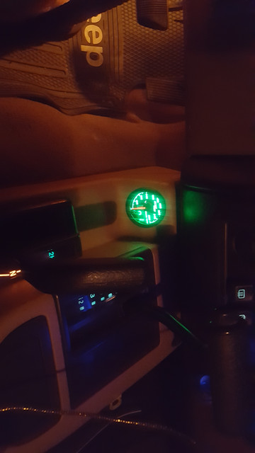

I installed a trans temp gauge as week last weekend too, running about 150 average up to 170 parked, and down as low as 130 on the freeway. All is well

Got my axle truss installed.i got the JCR one. It's not as hardcore as others, but it'll do for my type of wheeling. Been considering a d44 front and rear set up, eventually.
