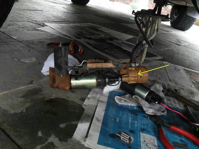

I recently bought a chopped 96. It was literally running on its last leg. The motor was strong just having issues. After a complete tuneup and no results I took the tank off. It looked like spaghetti sauce. Thorough cleaning and discovered the pump wasnt right. The sock filter was different. Ran the numbers and It was out of a 92 Town and Country minivan. Put the right pump in, and it keeps blowing the lines off the pump. Searched this forum and found I have a rare 96 with the fuel pressure regulator in the tank not on the rail. No vacuum or return line. I found this picture to show what I need(just what the arrow is pointing to). Sorry for the long post just wanted to explain what I need in detail. I have found the entire sending unit online, but Im kinda hoping someone has this laying around since I just bought a new pump itself. Thanx for your help....
what I would do so in the future it is an easy fix.Put a 95 unit in there and use a 03 grand cherokee filter regulator unit...just plump the extra return line from the filter unit right back into the tank for the 95 sending unit...and i used a mustang pump on mine for a 86 efi...which is everywhere in stock
This is very useful. Thanx a lot man...
