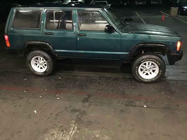

I came across this Craigslist post: http://sandiego.craigslist.org/csd/cto/4922803297.html

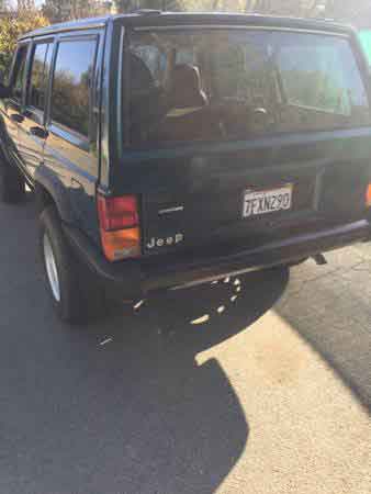

It certainly appears that someone has managed to install an old style hatch and tail lights on a '98.

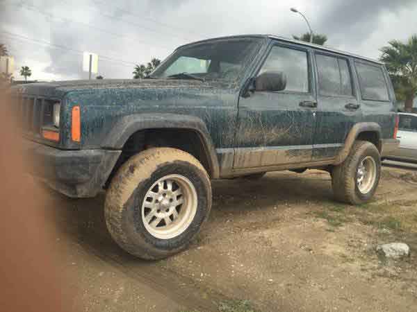

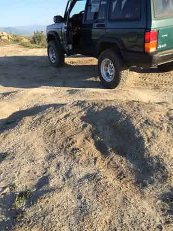

I know the C/L post won't last for long, so here are the most relevant pics posted by the seller:
Besides these there are pics of the interior and it certainly looks like a late model. No pics under the hood to see if there is a single fuel line/Renix bottle or anything else useful like that.
Title on the listing is "1998 Jeep Cherokee 4x4 - $3900 (Moreno valley)"
Text just says "98 cherokee 4x4 runs strong clean title current registration call or text (show contact info)"
It looks to me that the rear hatch doesn't quite line up with the body lines, but the pics are not entirely conclusive on that front.
I simply saw it and thought of this thread.

The C/L ad has some pics added to it, including a pic of the emissions decal. The year is over to the right hand side of the pic and at a bit of an angle, but it looks like it probably reads 1998. There is also another perspective on the hatch and it again looks like it does not quite line up with the body lines, maybe 1/2" too low.
Link to new C/L ad:http://sandiego.craigslist.org/ssd/cto/4922819041.html
Posted just to make the point that I do think someone has made the switch rather than tried to scam the unwitting.
Somebody has put together a Frankenstein Cherokee. The question is, how well, or how poorly was the swap done ?
