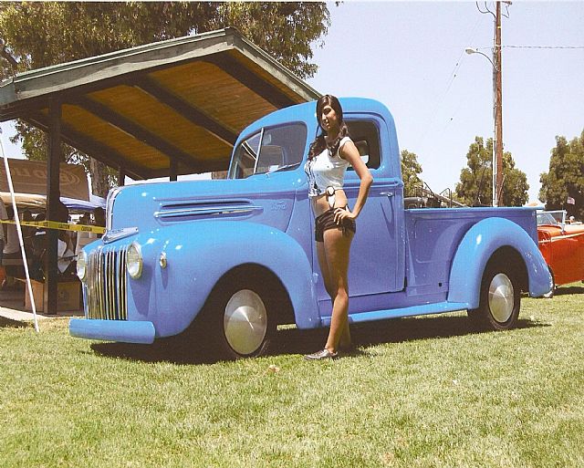

I thought maybe a few of you guys might enjoy this build. So here is The new project a 47 Ford truck. Original running flathead 4 cylinder engine and trans. Still in a planning stage but I am leaning towards a rat rod build. This will be a first for me and will be kinda slow going. If anyone has ideas, advice or know of few websites to check out let me know.
Slammed suspension, either chop top or no top. Depending on bed condition either run full bed or remove and do a cylinder gas tank mounted on frame behind cab.
