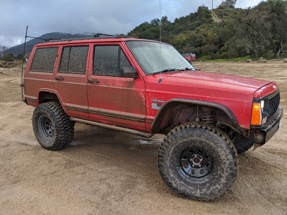

Looking to see what this combo looks like, riding at 3" rn with 30's. I plan on going with that combo and trimming fenders to the first lip. Thanks - Ghost. :spin1:

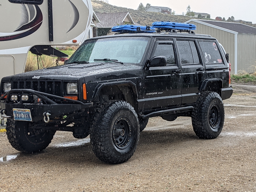

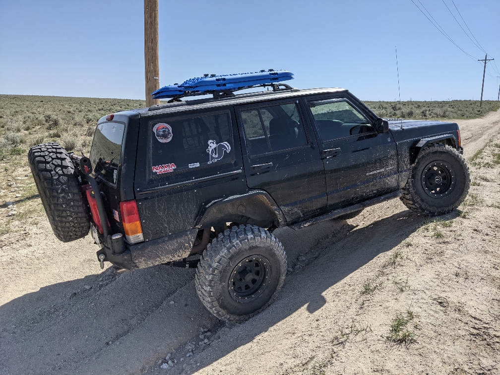

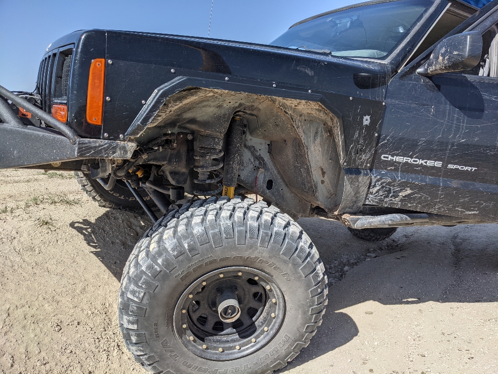

'99 XJ
OME 3.5"
BFG KM2 33 x 10.5 x 15
Trimmed fenders with Rusty's steel fenders.
Full disclosure: I have not yet tuned my bumpstops for flexed clearance but I see no reason to think there will be rubbage.
The front can fit damn near any size tire with little to no lift. The rear not so much.

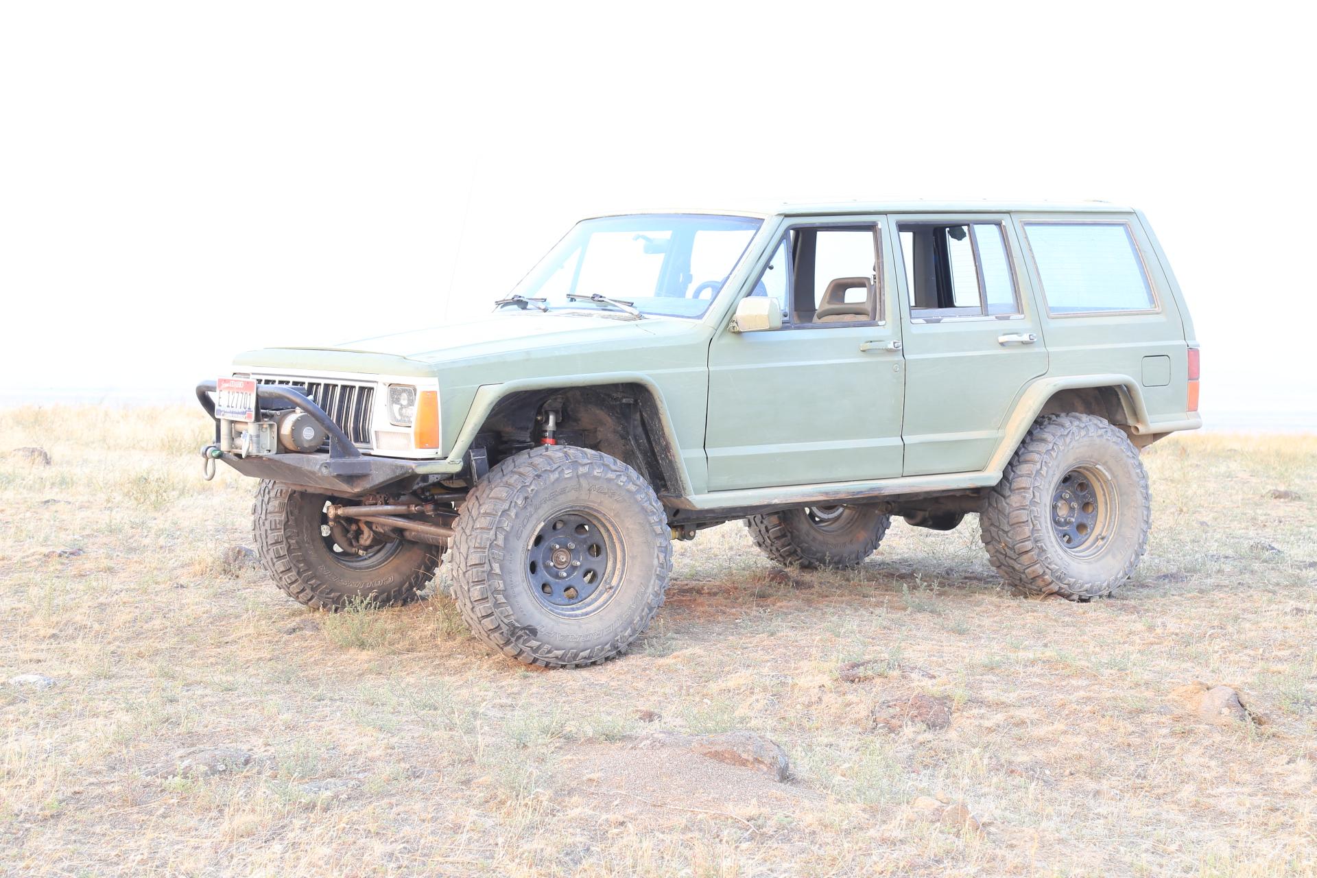

My 31s tucked perfect up front trimmed to the first lip. Moved up to 35s and did the standard cut and fold rear and trimmed the front to the moon.

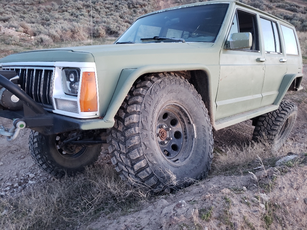

33x10.5 3.5" OME.https://uploads.tapatalk-cdn.com/20210124/5dc348950aaf3845e08d9c7bd538d9fb.jpg
Sent from my Pixel 4a using Tapatalk

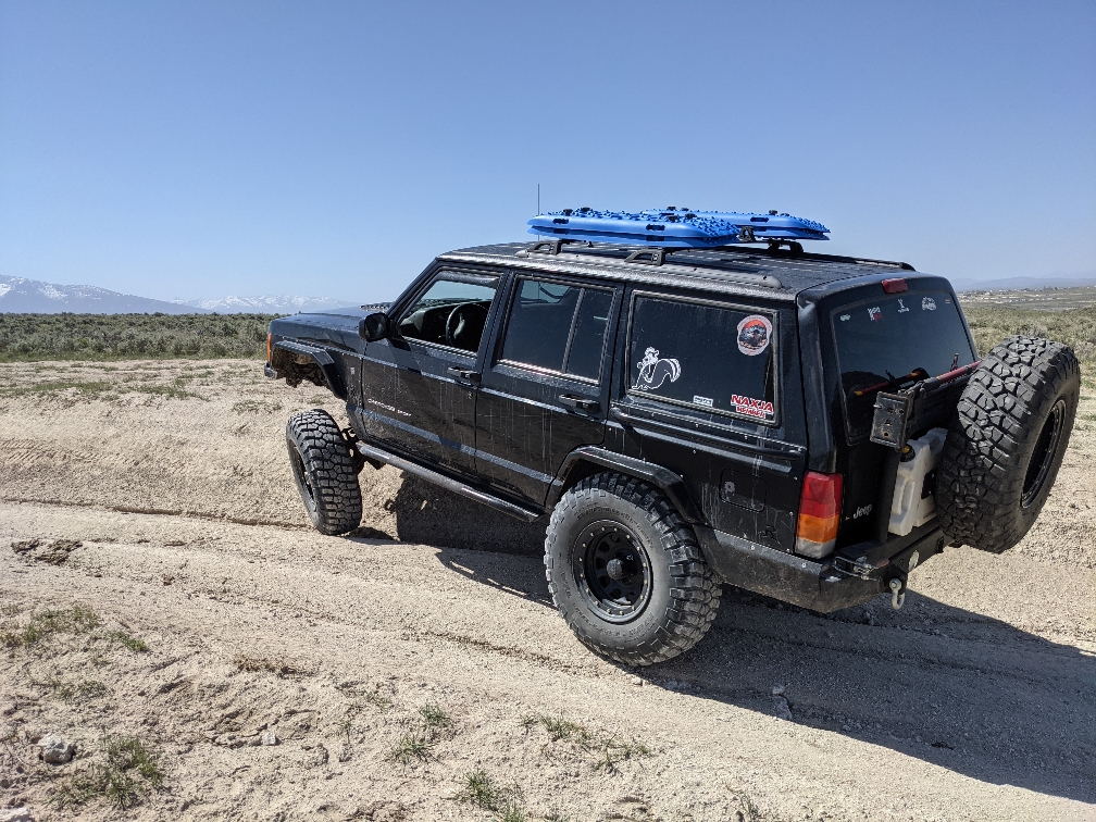

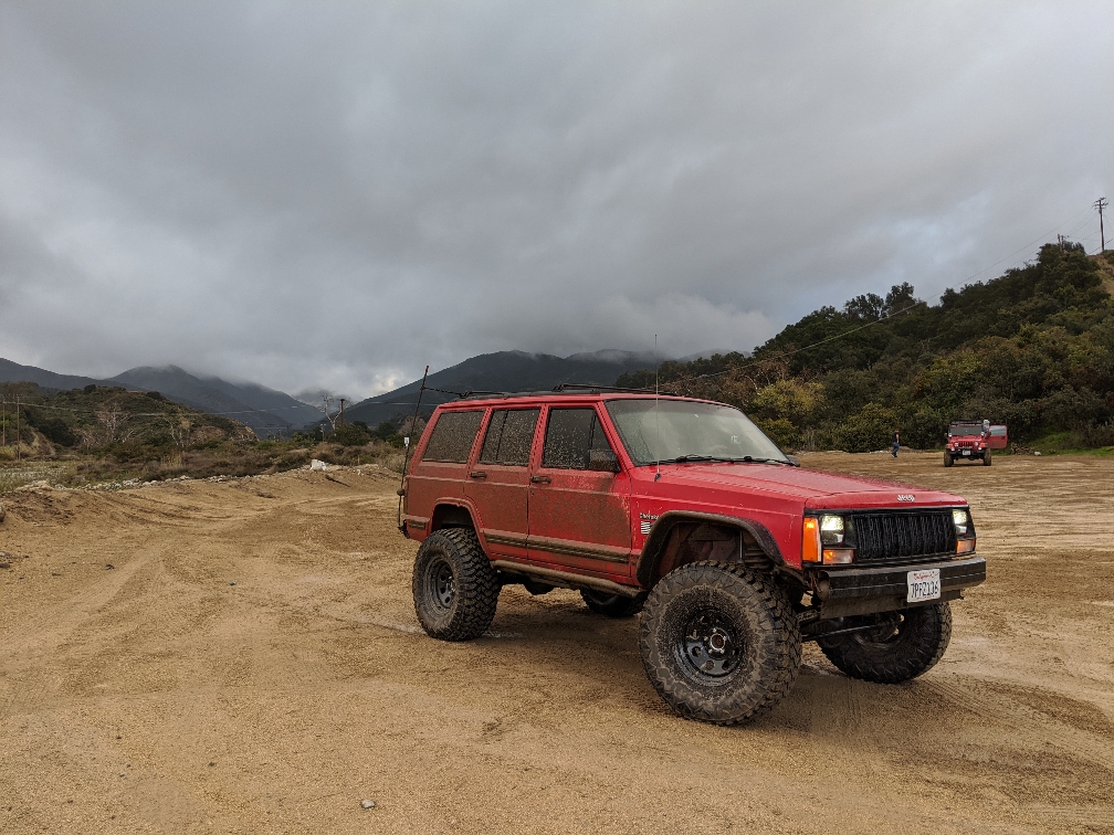

3.5" IRO rear (measured 4.5" with shackles) OME 3.5" front. 33 x 10.50 BFG KM2
33 x 10.50 x 15
Looks amazing. Love the stance
Thanks.
I'm gonna fight the urge to go 35s for good looks, at least until I test fit/drive a loaner set on the trail and get lots more wear outta the 33s.

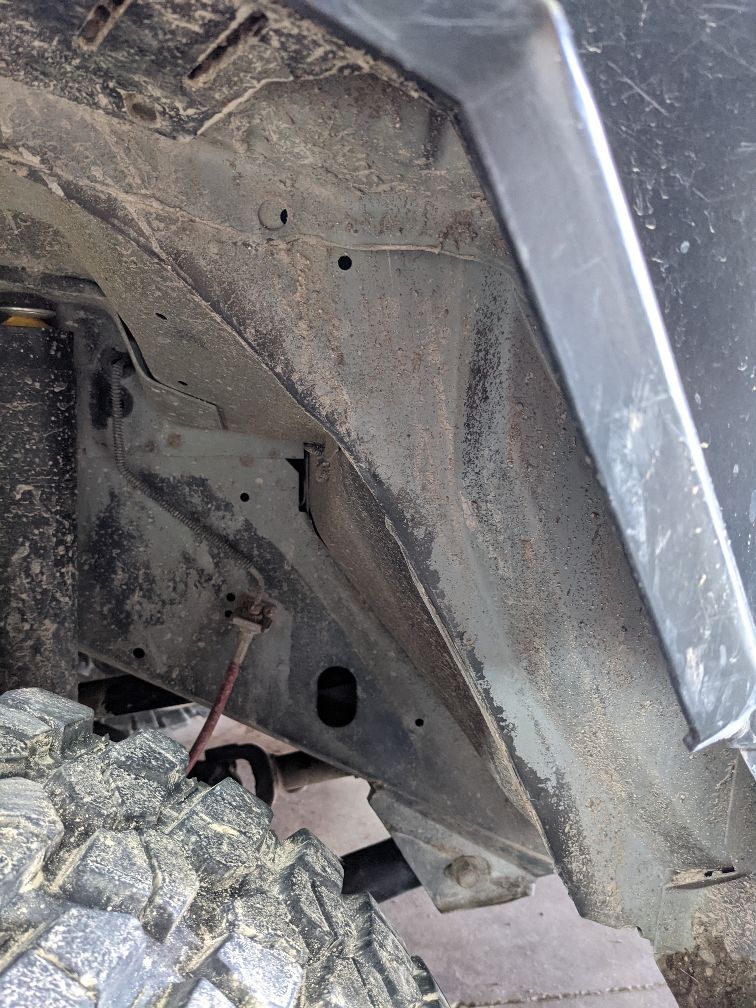

Question: I neglected to take a photo of how close the tire was to the inner fender pinch weld, like 1/8" at this compression. I'm thinking 35s might make contact. Is cut and fold something that's done, like the pinch weld fold when trimming fenders?

This is the pinch weld that I'm concerned with so close at squish. I know I can bumpstops to keep it clear but had some shock travel remaining the day I flexed it. Will do it again and take more time and measurements.
You’ll rub on the lower control arm before you rub the pinch weld.[/QUO
"1/8" at this compression"
And still had shock left. I'll do it again and spend more inspection/photo time.
The previous owner of my Jeep cut that and folded it in. Never been a problem with 33x12.5s
That was the question.. thanks.
33 x 10.5 are extremely close, at least on one side.
