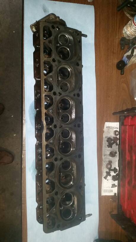

So I removed the valve cover to find out the lifters were bad SO I replaced them in addition to new head bolts, push rods, FELPRO valve cover gasket, FELPRO head gasket, valve seals, scrubbed and cleaned the head, lapped the valves and seats and the the head should be ready to go back in. What do you guys think?
Dumb question, how did you determine your lifters were bad?
Never a dumb question, just a jeep rookie taking a guess because they were loose and Im not really getting alot of help on here :( wasnt a final analysis tho, I had some new ones so I swapped them in.

I usually take my heads to the machine shop. I have used a few over the years and straight six heads always seem to need some truing up to make them flat. I know others check them with glass and lay them back down, but I've always had good luck going to the machine shop. Last one cost me $135 for all cleaning, valve working, and machine. I did bring them new valve seals.
