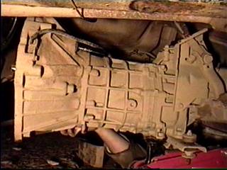

It is posible to have the AX5 with the 6cyl, just a little unusual. The two trannys look pretty similar, but the biggest difference is the location of the drain and fill holes. As I recall the drain hole onthe AX5 is on the bottom and the fill was on the drivers side. I think the internal clutch lines come off on the opposite side too, with the AX5 heading out the passenger side.
http://www.jeeptech.com/trans/ax5s.jpg
http://www.jeeptech.com/trans/ax15s.jpg
