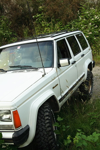

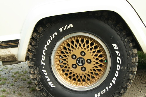

Ok so as most of you know I went to NWFest with a stock XJ and had a blast, but didn't get to do any real trails with it due to the stock status. Well I finally got the exasperating 3" lift and 31's BFG Mud terrains on and thought I'd throw some pictures out there! I also have a few other goodies from various NAXJA members to put on later this week.

Tucked with rub. Does anyone want to tell me how to trim my wheel wells (front and rear)? Also what about the rub I have on my front sway bar?

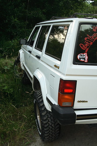

Repping the NAXJA sticker, dont you think I should become an "honorary" NAXJA member? :wave1:

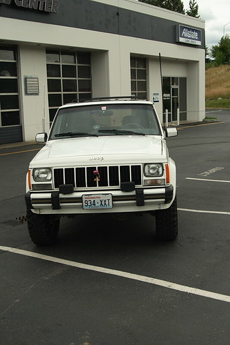

As she sits today.
So yeah, what do you guys think? After I get my paycheck Tuesday I think I'm going to order some AJ rock sliders, and try and find some junkyard armor...as I need more.

We also need a pic of your rig on flat ground for posterity.
