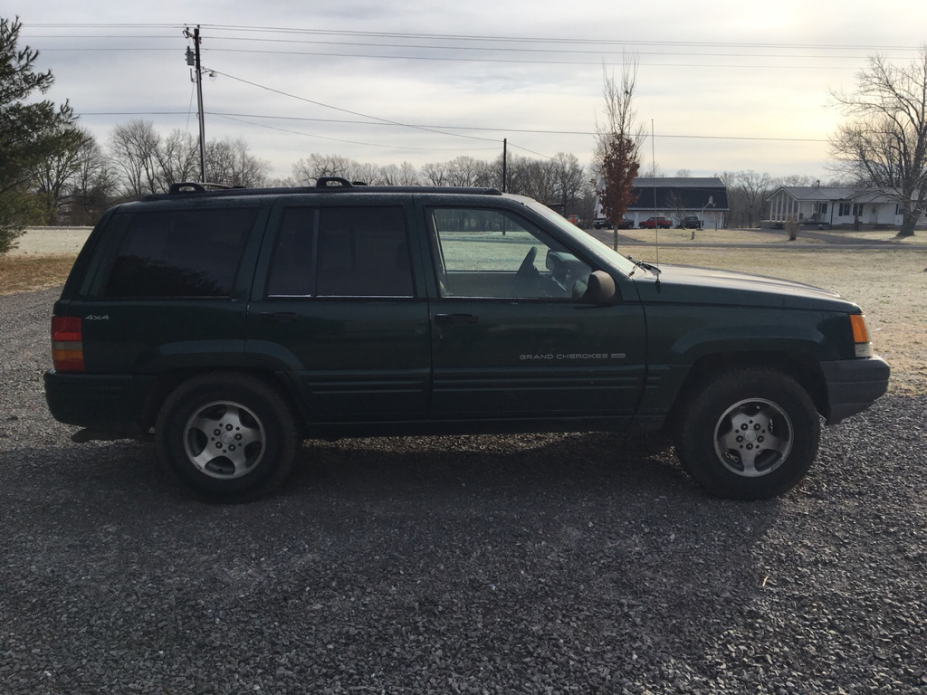

I thought it would be a good idea to start a thread documenting my experience of owning a 1998 Grand Cherokee. Maybe I can help some other owners along the way.
We needed to get a vehicle for my wife to drive and I wanted it to be an XJ so I could work on it. XJ’s were few and far between when I started looking. Then I decided to widen my search to include 93-98 Grand Cherokees. They were in my budget and seemed to have a lot in common with the XJ. I wanted a 4.0L and 242 transfer case for ease of parts and reliability and commonality of parts with my current fleet. Transmission and electrical gremlins seemed to be their weaknesses.
We bought it on March 17, 2015 from a guy in Hazel Green, Alabama. It was $2500 and had right at 119,000 miles on the odometer if I remember right.
It was really clean but needed a little work. It had a steering box bolt broken and needed tires but that was all stuff I could easily do. It had a 4.0L, 42RE, NP242, D30/D35 and 3:55 gears. It drove nice, interior was almost like new. With the low miles, I figured the transmission was good for a long time. It had a cracked exhaust manifold.
I was happy with my purchase and felt I’d found a reliable vehicle for our family.

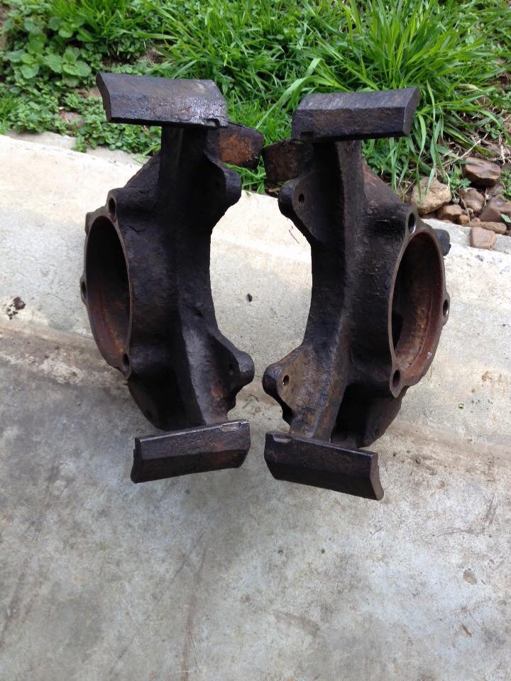

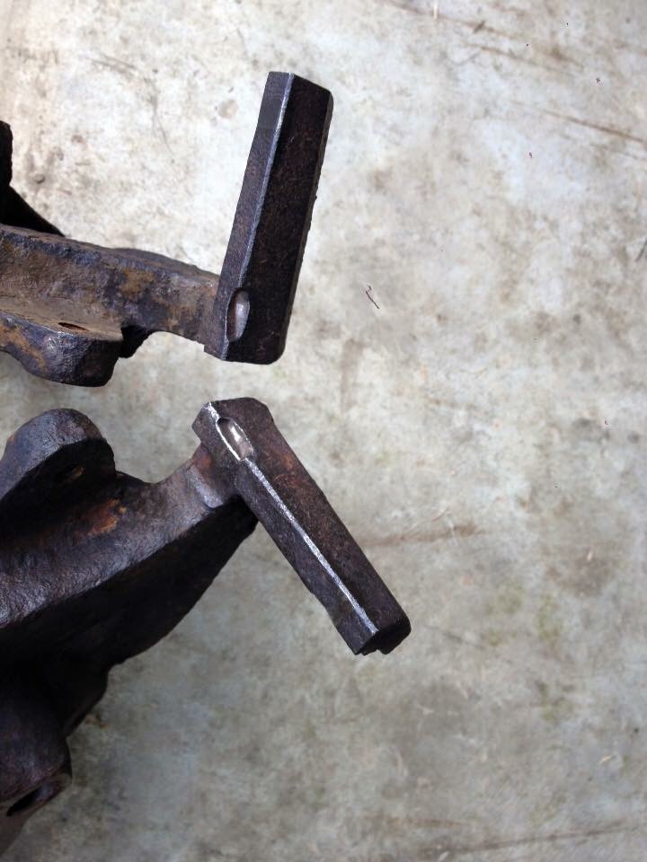

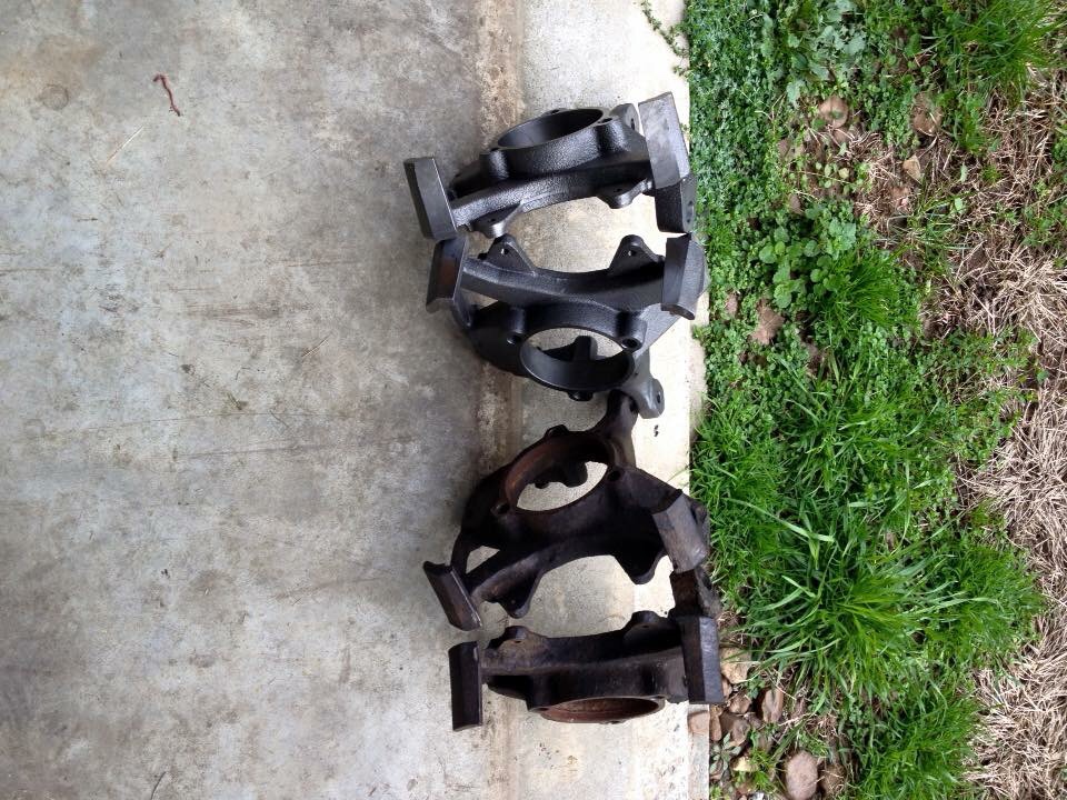

While doing the front joints I noticed the knuckles were really worn from the brake pads.
So I ordered some new Dorman knuckles from Amazon.
I got everything put back together and felt good. But guess what......the vibration was still there. After a lot of research and opinions from mechanic friends, the worst was realized.....the overdrive in the torque converter was failing/bad. So much for a low mileage ZJ having a good transmission.

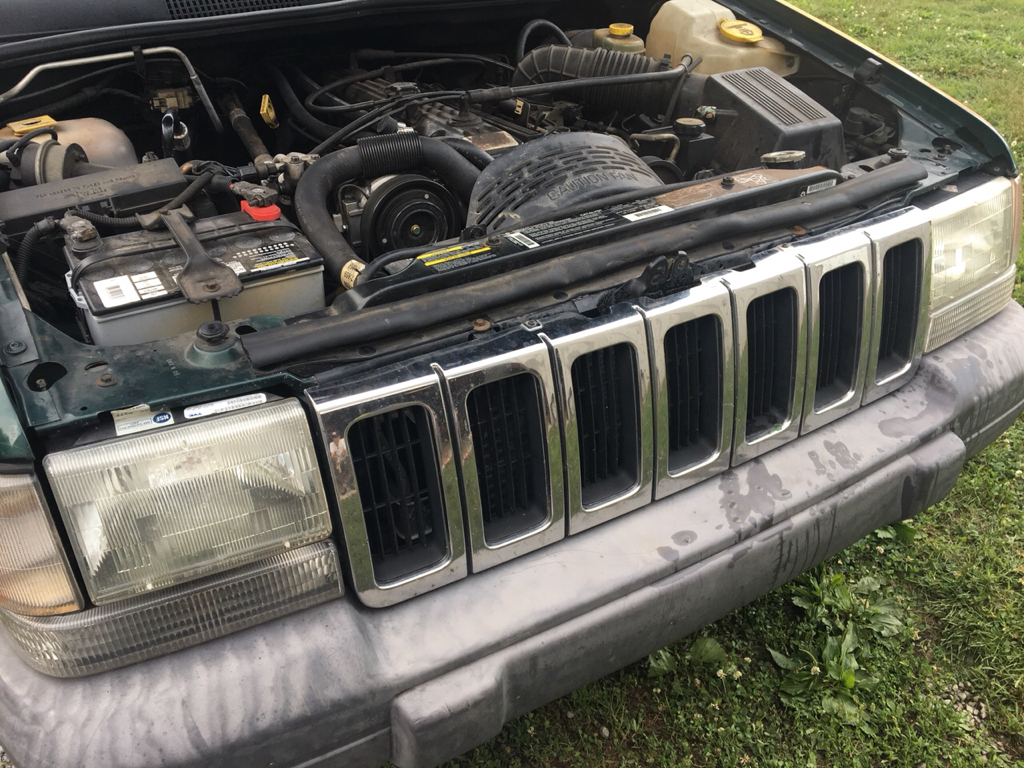

..........one day the side plastic radiator tank decided the split. While I was in there, I was determined to replace the radiator, hoses, water pump, front plastic core support (it was cracked and JB Welded back together), headlights and marker lights (also messed up and JB Welded in), and replace a clutch on the A/C compressor that began smoking one day.
I got everything put together and it was pretty straight-forward as everything just had to be removed and then replaced. It took some time but it went pretty well.

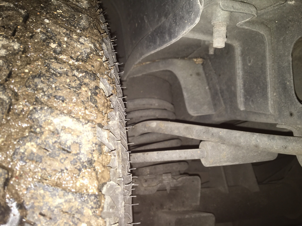

This past winter we went to go to my parents for Christmas that evening and something didn't seem right. The back passenger corner spring was totally compressed. At the time it was very, very cold. The shocks have been questionable since the day I purchased the ZJ as they looked pretty old but they were not original OEM style units.
The best I could figure is the shock had been leaking some oil and the piston might have taken in some water and then frozen up. The spring never did "uncompress" until the next day when the sun came up and the temps increased to above freezing.

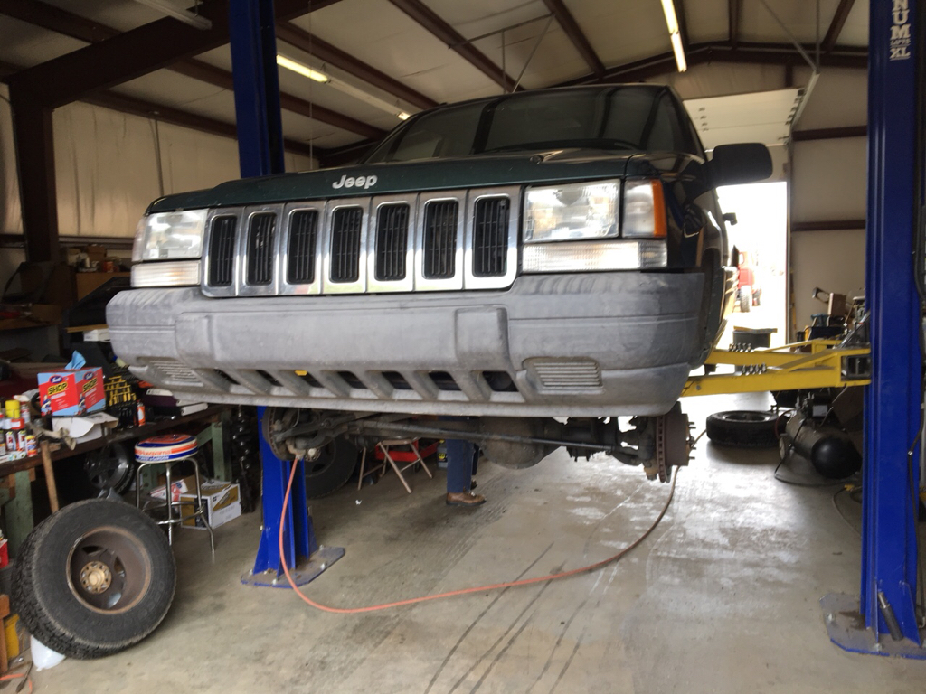

This was my excuse to get some shocks so I used Kolak to order four brand new Bilstein 5100 shocks for Verde. We ordered them based on a future upgrade of removeing the old 1.75" coil spacers and going with Some OME 2.5" coils down the road.

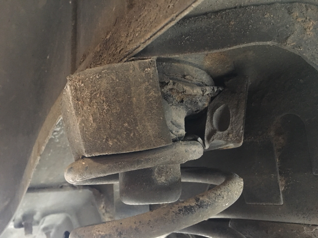

Everything went together pretty easily but when working on the drivers rear coner we noticed that the 1.75" coil spacer had split. Luckily I had an extra one as they are the same as the XJ spacers. We swapped in a new (used) one and got it done.

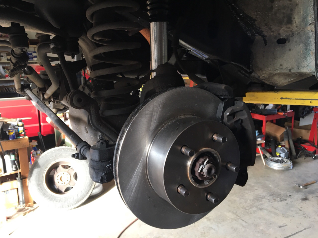

While on the lift we noticed hairline cracks in the front rotors. I had a set of new rotors and ceramic pads on the shelf so I swapped them out. I also preformed an oil change and tire rotation while it was on the lift.
It was a busy day but I was able to get a lot of stuff done with the help of Larry.
Here are some pictures of the coil dealio.

Here is another view of the spring and the way the Jeep sat.

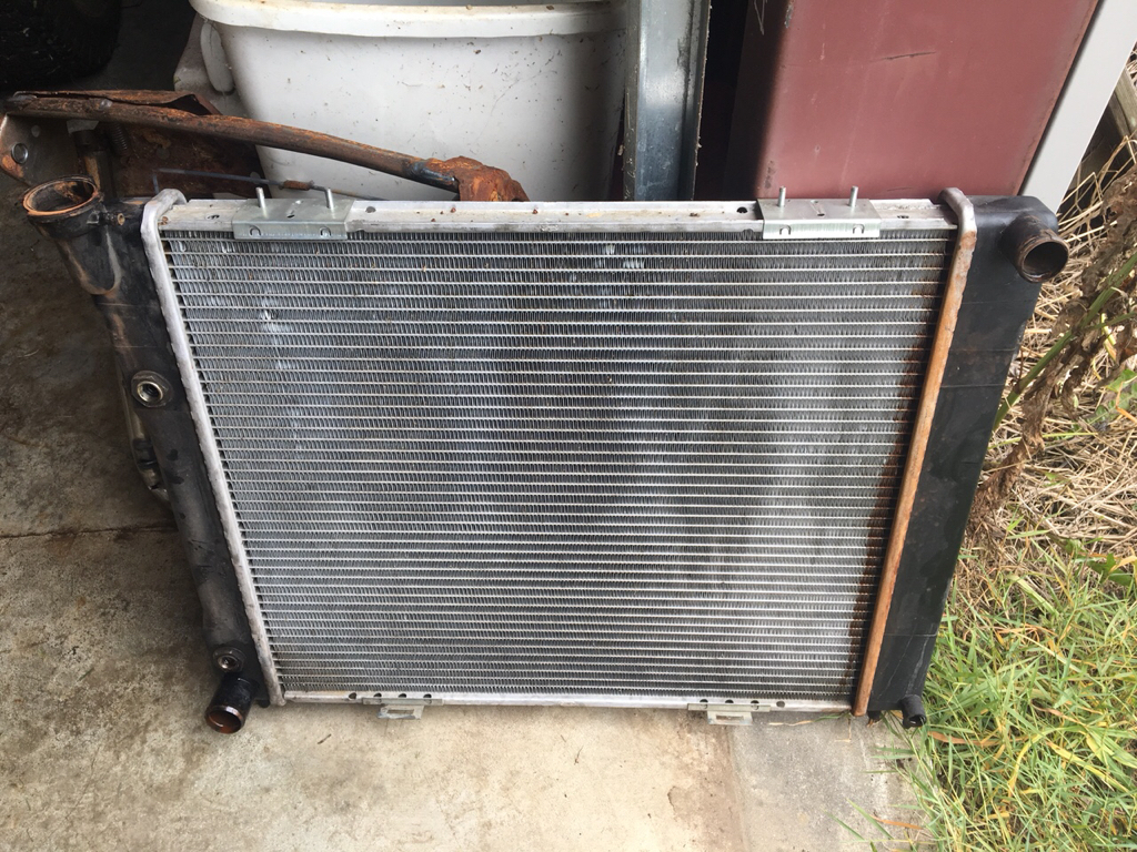

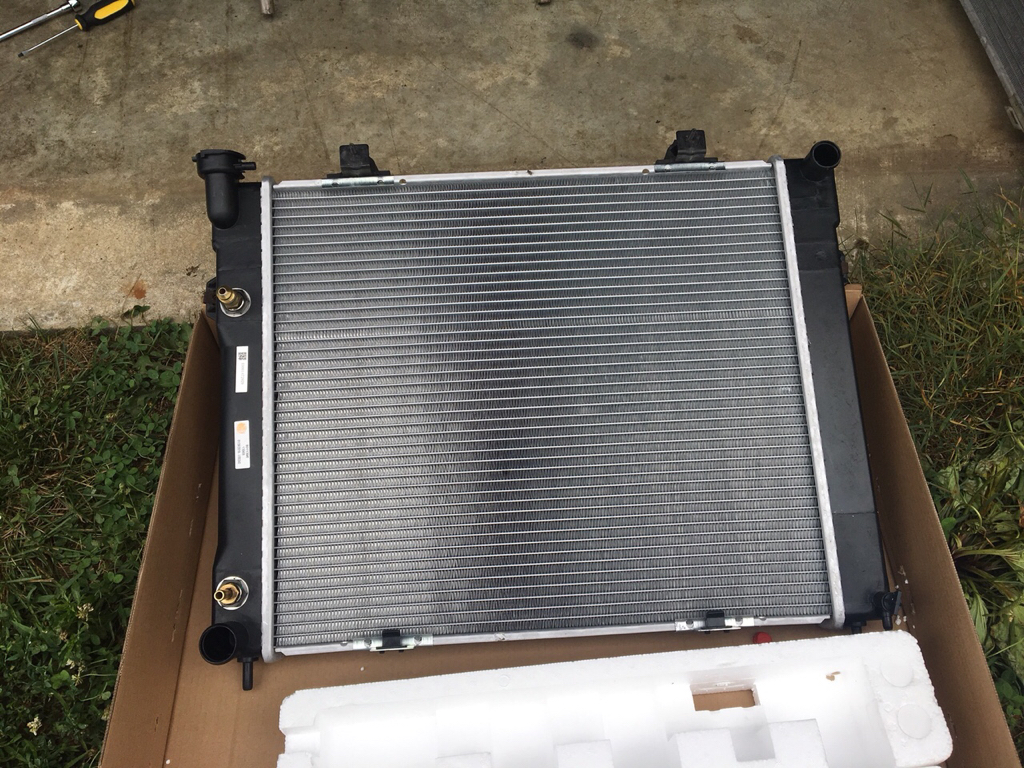

So about a year ago I installed s new radiator. We noticed the Jeep was losing some coolant from the passenger side tank. Aluminum/plastic radiators are the dumbest design ever!
Here we are doing the job again.
All done. Runs nice and cool, idling with the A/C running. Hasn’t broken 210* yet.
