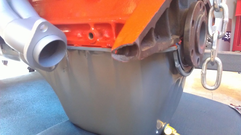

Personally, I would recommend that you support the front of the engine on the stand. I built my motor last summer for my '99 XJ. I had it on the stand for 2 months while I built it, acquired parts, etc. I was in the process of hooking up chains to it to move it from the stand to the lift when the unthinkable happened:
Luckily, I found an awesome welder who was able to fix this for me as it was a clean break and the threads were intact. We put the piece back on, with the bolt threaded in and then welded it. I created a "strap/bracket" out of flat stock that I wrapped tightly around this "ear" and then bolted it through the webbing in the block in two places. I've run it, hard, for a year now w/ no issues.

That is worst case scenario! How many f bombs did you drop? Lol
Funny you should ask. I cussed/screamed/punched so much stuff I had to go in the house, take a Xanax (or three!) and go to sleep. I actually puked over it.
After asking various lists (naxja, jeepforum, etc.), talking to welders, etc. - everyone said it was f'd. I finally found a seasoned welder w/ the correct rods who was willing to take it on (at my house nonetheless!). After he was done and I did my cleanup, you couldn't even tell. I added the strap to reinforce it and make myself feel better.
