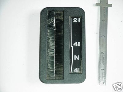

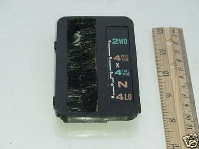

It sounds like you have the NP231 transfer case, which did not have the locking centre diff that the NP242 did. Easy way to tell: if your transfer case selector positions are 2HI, 4HI, N, and 4LO, you have a 231; if they're 2HI, 4HI Part-Time, 4HI Full-Time, N, and 4LO, you have a 242. To double-check, crawl under the Jeep and look at the tag on the transfer case. FWIW, full-time 4HI is basically an AWD mode; only the Part-Time light will come on if you have a 231.
Top is the 242 TC
Bottom is the 231 TC
