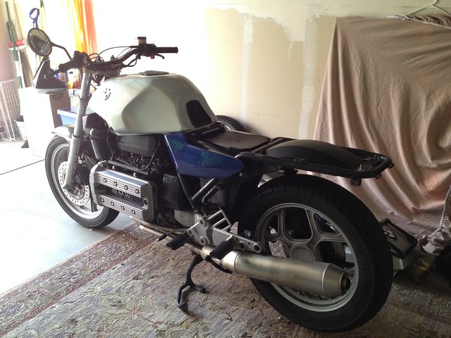

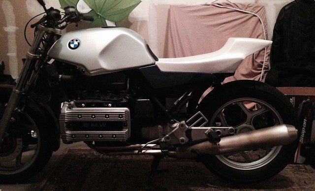

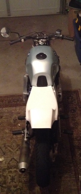

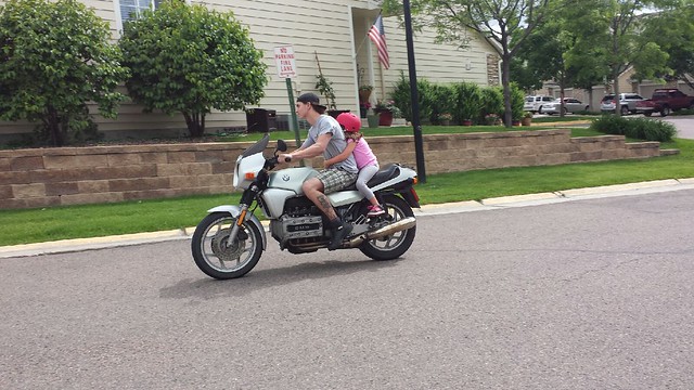

A couple weeks ago i went and looked at a k100 and ended up buying it! The good thing is i talked the PO down on the price and was able to buy it and still have some $$ left over from selling my other bikes. Here it is at sloans lake the night i bought it.
If you dont know anything about k100s....its a bmw with a fuel injected 1000cc motor that is pretty much a bmw 4cyl car motor on its side. It has a single sided swingarm, monoshock, and is shaft driven. Pretty far ahead of most other bikes being produced in the 80s!
Ive been riding it for about 3 weeks now and its a really fun bike to ride, ive found a few of its shortcomings that i hope to improve upon over the next few months and over the winter months for some of the bigger projects. I changed out the beach cruiser bars this week for some daytona style bars that let me stretch my long ass arms out a little more, and taken off a few little things here and there.

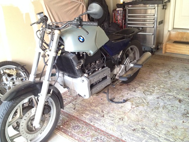

I made a trip over to woody's wheel works today and picked up a set of wheels off of a newer bmw k1200! The stock wheels on my bike are 2" wide in the front and 2.5" wide in the rear and my new k1200 wheels are 17x3.5" in the front and 17x5" in the rear.
Right now my bike has a 100/80/18 in the front and a 130/90/17 in the rear... but with these new wheels ill be able to run a 120/70/17 in the front and a 170/60/17 in the rear.
Not only will my bike handle better with modern sized radial tires, but it will stop better with the 320mm dual disc setup on the front, and look pretty badass with the new rims!
