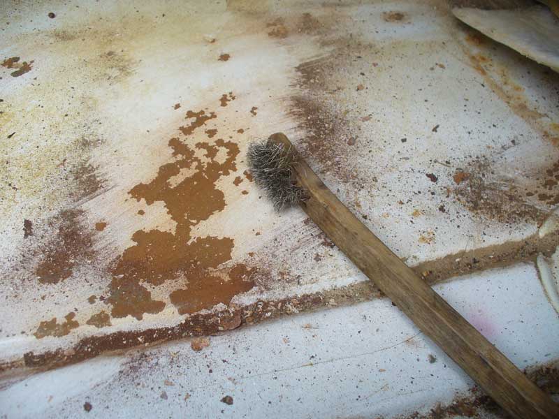

Now I also have gathered that the passenger side is usually worse. I decided I probably better remove the passenger seat and lift the carpet on that side too. As I kind of expected, things were worse on that side, but nothing too severe. I got a small wire brush and started working to get a sense of what was there:

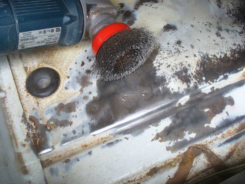

The wire brush is a slow way to go and won't really clean things up well. I stepped up my game a bit:
That is a bit more like it.

This is a situation where I thought I was going to just be brushing away an accumulation of fine dust:
The paint released entirely, but left bare metal behind. I am guessing that I caught this right at the beginning of the loss of protection from the paint. I expect the dust held the water there. Another year or two and it would have been rusting. The lesson there is to get the dirt out before it can hold the water and start the deterioration process.
I also noticed that the rust was predominantly in the high areas, not the low areas.
Note where the paint has been removed and where it hasn't. I instinctively tried to bury the wire cup in those grooves expecting them to have rust. That is why there is so much shiny metal around those grooves. I hardly found any rust there. It was almost all in the higher spots in the floor. What is happening is the carpet padding is holding the water and keeping it in contact with the high points.

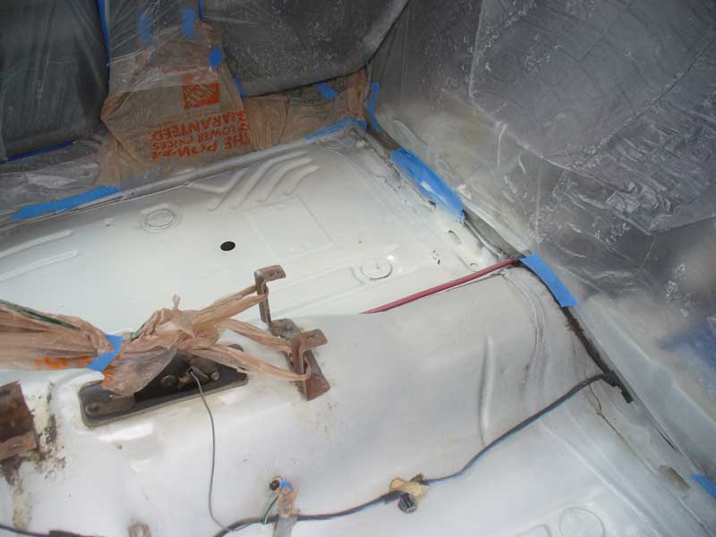

The worst rust I found was above the exhaust in the rear seat footwell. I don't seem to have a good picture of just that area, but you can see it in this picture:
It is rusted through there, but it is a pretty small area. The holes are no bigger than 3/8". It could be much worse.

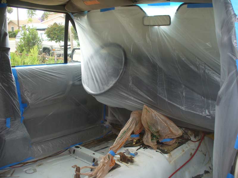

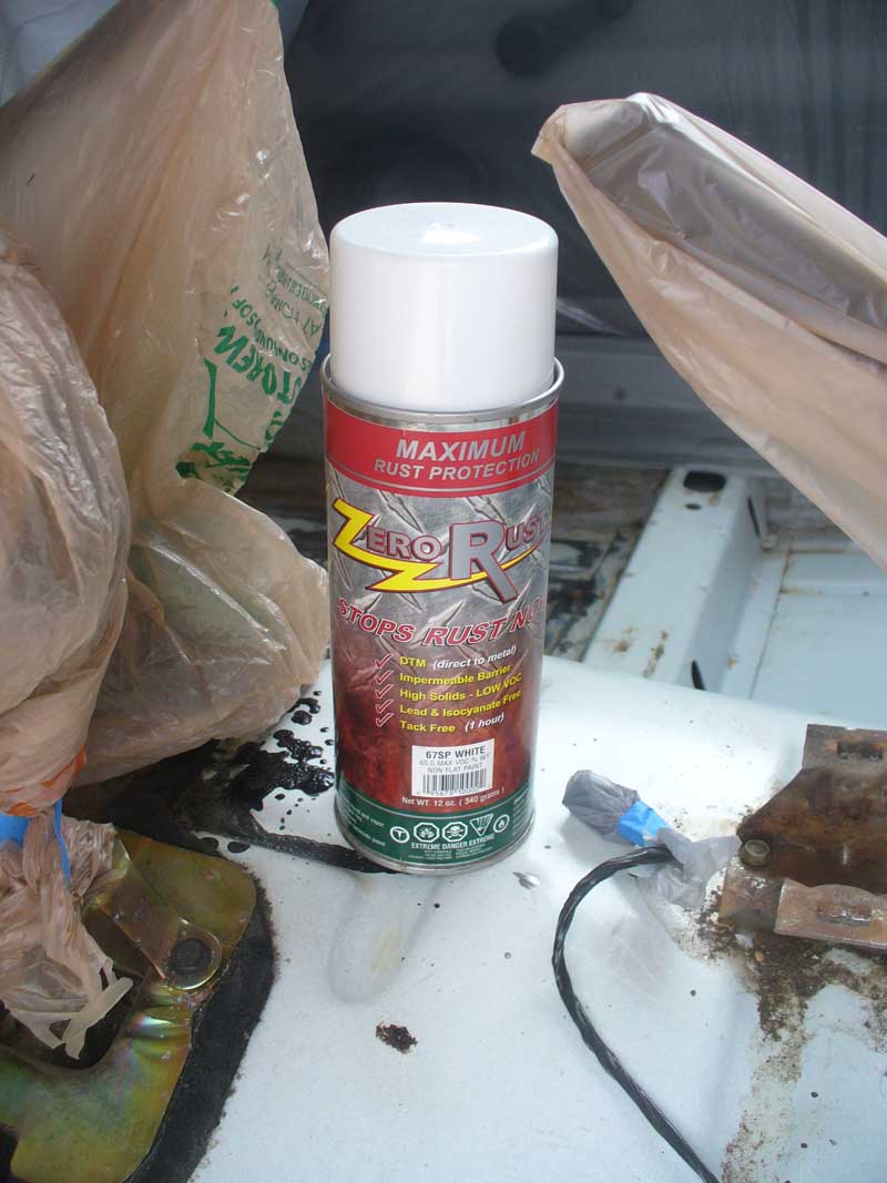

I took the wire cup to everything that looked suspicious, vacuumed out all the debris and then wiped everything down quickly with acetone. I am sure there are better products, but that is what I had at hand, and it is a holiday weekend. I doubt I would find any automotive paint stores open. Then, while letting the surface dry from the acetone I masked off the interior. I may have gone farther than necessary on this step, but I don't want to spend the future looking at a bunch of preventable overspray.
The product I chose to use was something I already had on hand. Again, this may not be the best product. In fact, a brush on product such as POR-15 would save the masking step. According to the marketing folks behind it this product should work, but marketing is often just another word for "fraud". If anyone has better suggestions they would certainly be worth considering.

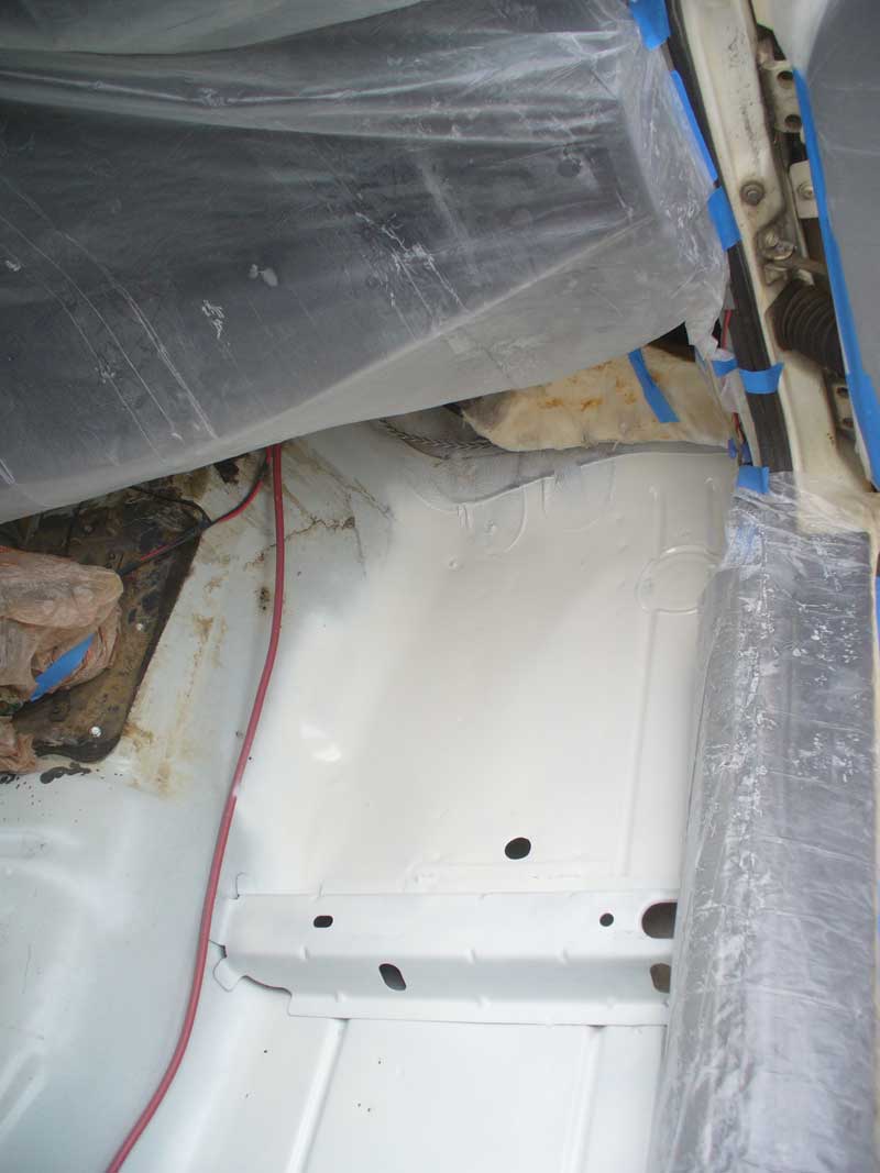

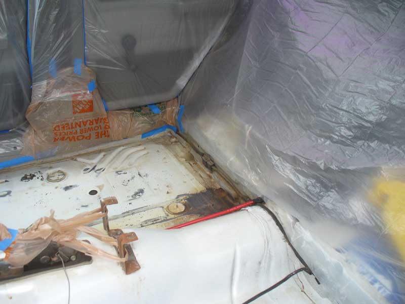

The following pictures are of the results so far.

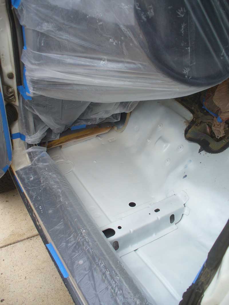

The worst spot:

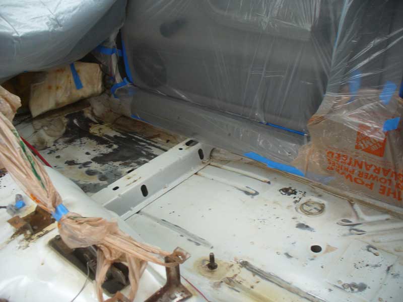

Passenger foot well:
Driver's foot well:
A comparable picture of the first one in which I pointed out the bad spot above the exhaust:
One more of driver's side, showing masking more than anything else:
I figure I probably just extended the life of this XJ.
The worst spot:
Driver's foot well:
