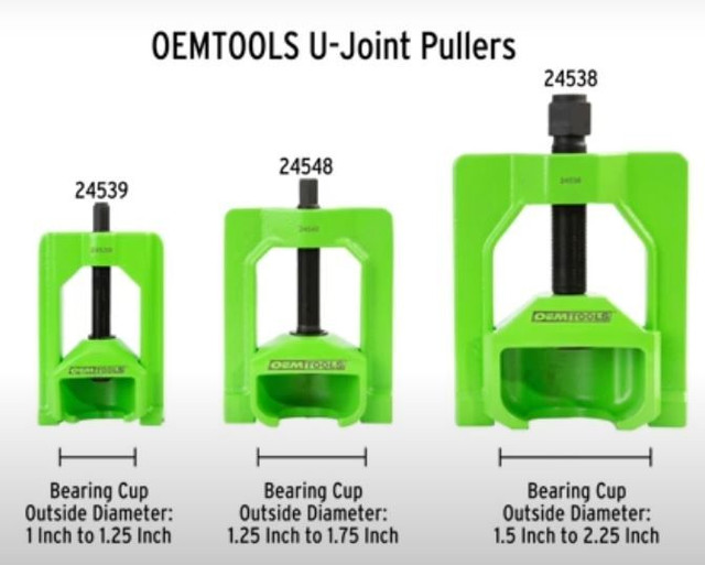

I could never do it with a hammer and a socket like many do. Years ago I invested in a harbor freight u-joint/ball joint press. Money in the Bank
Here's my technique: I have a piece of u-channel that I stick underneath, supporting the sides of the ujoint cross. Then I stick a big socket on the top and press on that. This forces u-joint upwards, and the upper cap pushes out into the socket on top. That way, you're only pushing one cap at a time, and there is no force trying to bend the shaft ears.
Unless you used an acetylene torch and got them cherry red hot, they are fine. Ugly, but usable. I would source good used replacements with the larger u-joints, $18 each at my local Pic-n-Pull.
Proper tools save time, and prevent curse words, damage, and added expenses.
That tool still can still bend the opposite side ear!
