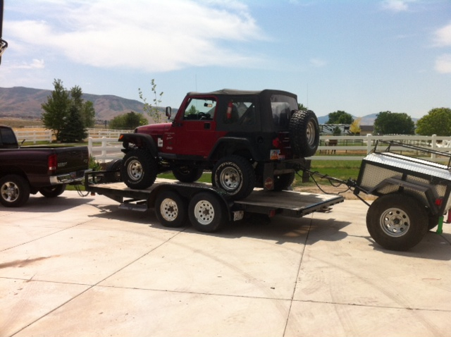

My M416 parts came in and they have worked out great for me .
I didn't get a pic of the front casting before it got installed.
Here they are Installed , You can also see the open ends on the frame we have cut those at a 45* angle and capped them since then.
Then we cut out a piece of a s10 tailgate to fill the hole where we removed the front portion of the trans hump.
I left the rear portion to divide 3 compartments for storage that will be under the platform floor I will add to make the floor even in the trailer .
Here you can see it connected it was able to jack knife to 90* before we even cut the front corners of the frame at a 45*.
This was the first day it moved, we towed it around the neighborhood.
This was the first trip out of the neighborhood, we made it up to 40mph on the windy,hilly back roads by my house.
I removed the sway bar on the trailer before this.
( still unsure if it will stay that way)
Chachi followed me in his Green XJ
And finally we drove it on the highway out to Chachi's and broke 70 Mph on a long curve with a few bumps, It seems to tow Very Nicely and backing it up isn't so bad either really.
Out at Chachi's my buddy Corey Did lots of sanding and finishing and will be Spraying it With Silverstone grey metallic If all goes as planned tomorrow morning.
Here it is after we painted the frame and roof rack with a semi gloss black , and then started on the taping off of the roof rack, frame, windows and did some final sanding.
