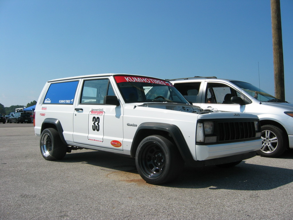

http://grassrootsmotorsports.com/reader-rides/4639/
this was more or less my original plan. In a perfect world where money wasn't a problem, I would have done something very similar to this with my xj and bought a late model and followed something very similar to Darren's ideal rig plan for an off road rig.
