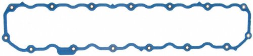

I need to fix a leak and wondering which of these Felpro gaskets I should get. I have a 1997 XJ 4.0. Amazon is saying that the VS50458R is correct, but I thought that they were all the same other than the early Renix which used cork and an aluminum cover.
Fel-Pro VS 50522
Fel-Pro VS50458R
https://images-na.ssl-images-amazon.com/images/I/51Ql9KoYEYL._SL1500_.jpg
You want the VS-50458R-Fel-pro
or the Mahle VS-50266 ,which on the gasket I have in my hand,have the same part #
