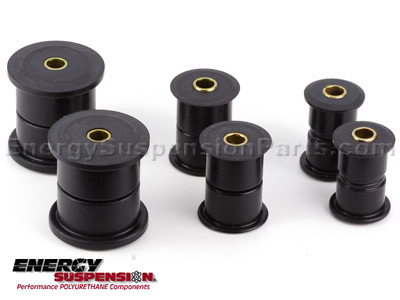

2.2109 Rear Leaf Spring and Shackle Bushings
Part Number: 2.2109
Manufacturer: Energy Suspension
Color Choices:
*Black
*Red
Price: $43.65
http://www.energysuspensionparts.com/proddetail.asp?prod=2.2109

i have the rusty's springs and they had gone bad of course.... i ordered the energy susp. bushing kit, and found the front eyes are 2 in not 2.5 like the oem. i just got out the grinder and went to town till they fit.
