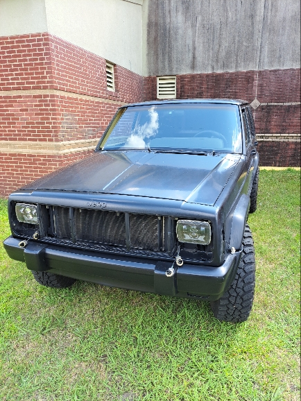

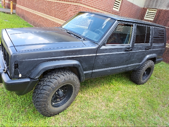

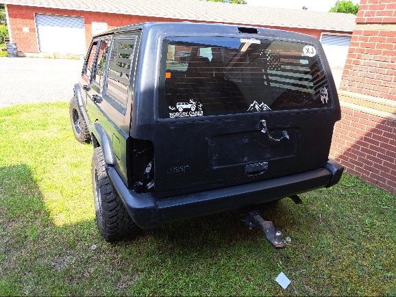

I decided to spray my XJ with tractor low gloss paint. The very next day I had the bright idea to wet sand and buff the paint to get out the dust and orange peel texture. Bad idea. You're supposed to wait at least 2 weeks after you spray to ensure the paint is cured. Now I'm looking at shooting it again or just taking down a trail and saying screw it! Or do I camo it out military style

I used Krylon Tractor and Implement Paint from the Tractor Supply Store near me. I bought low gloss black and it is single stage and cut it 3:1 ratio with Acetone as directed. The instruction also said roll or brush on. I sprayed it with my HVLP gun. The paint was supposed to cure for a week before I started the color sanding. It was only about 90 dollars worth of material used. It beats the rust that was coming through the primer. I was planning on keeping this a very low budget build due to my other long, on going project.

The instructions on the tractor paint didn't call for anything but the acetone to spray it. It was mixed 4:1 if I remember correctly. Just wait at least 3 days to cure before you wet sand it. I tried mine the next morning and it wasn't cured yet.
