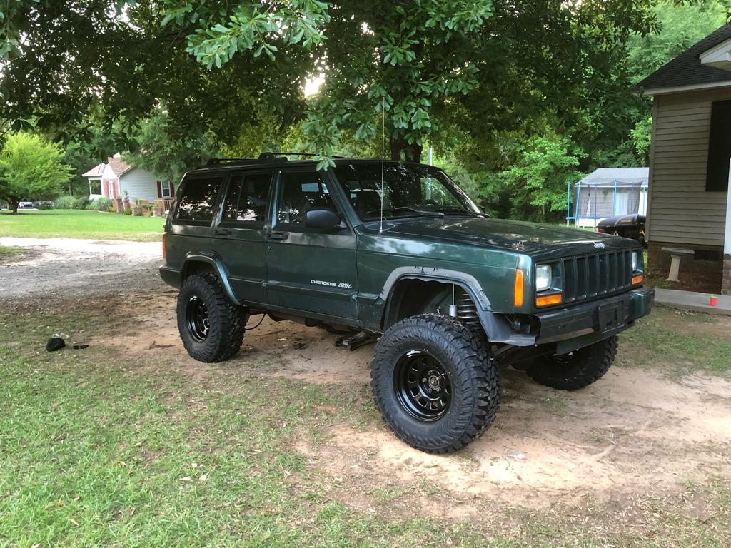

I’m putting 32 inch tires on my xj and don’t know much about gears in the front or rear and what ratio would be best for this tire size?
That's a nice looking xj I'll let the experts chime in on gearing choices.
