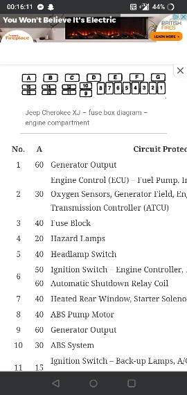

For knowlege that'll save me some trouble - which fuses?
I believe the two (2) that say "generator output". #1 and #9

How did this thread go from low voltage causes, to a fuse topic? A blow fuse kills all voltage / power on the outbound side of the fused line. That image does not look like Renix late 80's XJ set up, mot like late 90s model. The early 85-91 models were known for undersized wiring, corroded and over heated connections that led to hot/voltage drop loctions at connections, and switches, Like the ignition switch and Blower fan, etc... Connections at the Battery as well is where one looks for corroded, loose contacts that are prro conductors that lead to a voltage drop.
