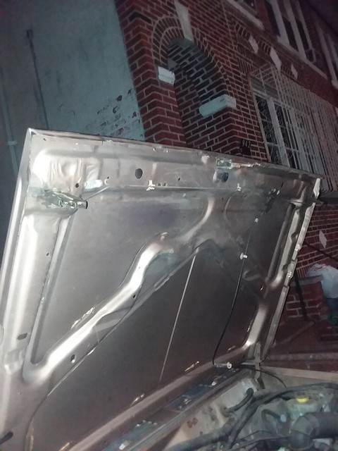

This is where I may have went wrong. If I had waited for suggestions, I would have left the the corner latches in and tried to release the center latch from underneath the carriage.
Open!
- Removed the two bolts behind each of the headlights to release the two end latches.
- Removed the skid-plate.
- Slid a wooden-pole up between the fan and radiator, pushed up on the front-center of the hood
- Hood opened enough for my buddy to open it all the way.
Yeah!
Ready to re-install...

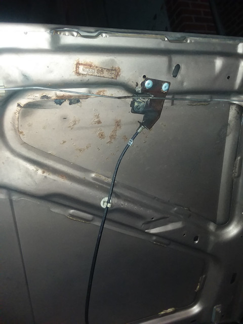

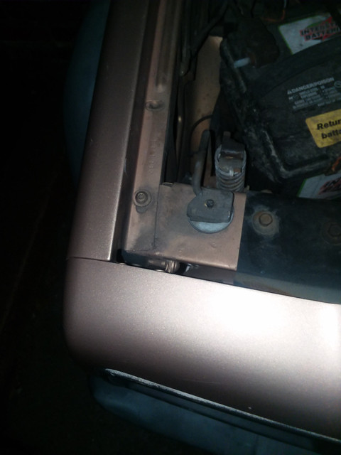

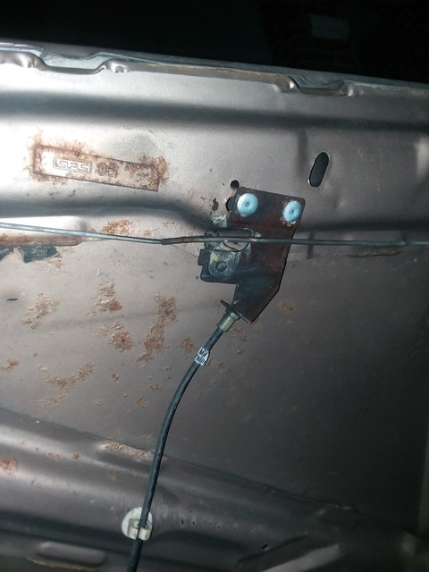

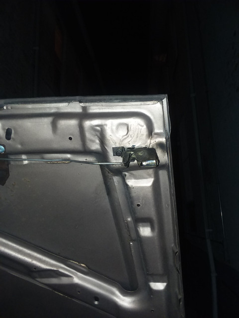

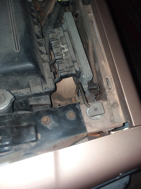

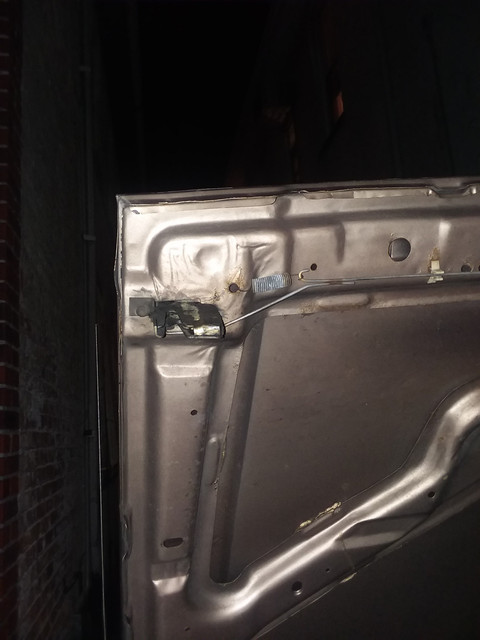

Parts cleaned, ready to re-install. I could use a couple of pictures showing the area under the hood latch/spring area... Help?
Hood-release is way too tight when re-opening the hood. Help?
