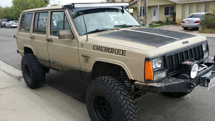

Here's mine on 4.5" of lift and 32"s. You should be able to fit 33"s no problem.
