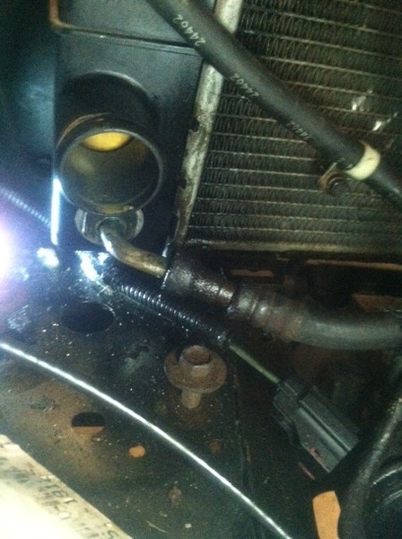

Driver side transmission, lower transmission line

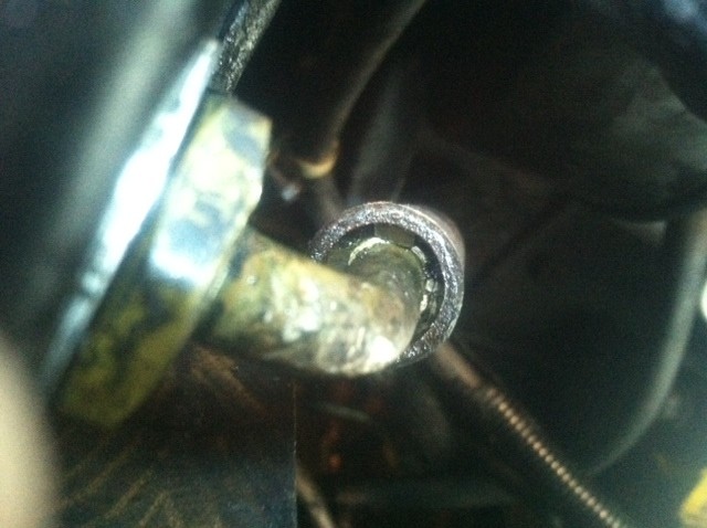

Spring clip evident when looking closely

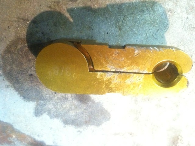

3/8" spring clip tool from Harbor Freight (I already broke the little circlip off of it to be lost in the engine bay somewhere).
I just replaced the radiator on a 99 that had the metal clip. I used the fuel line tool to remove it. I had to replace the O rings in that fitting and that was not fun at all.
That fitting has four (4) small metal prongs that all need to be retracted at the same time,
while pushing the hoses together - and then pull them apart. Of course, you need to use
the proper sized fitting release tool. Even if you have the tool, it still is no picnic to get the
fitting to let go.
