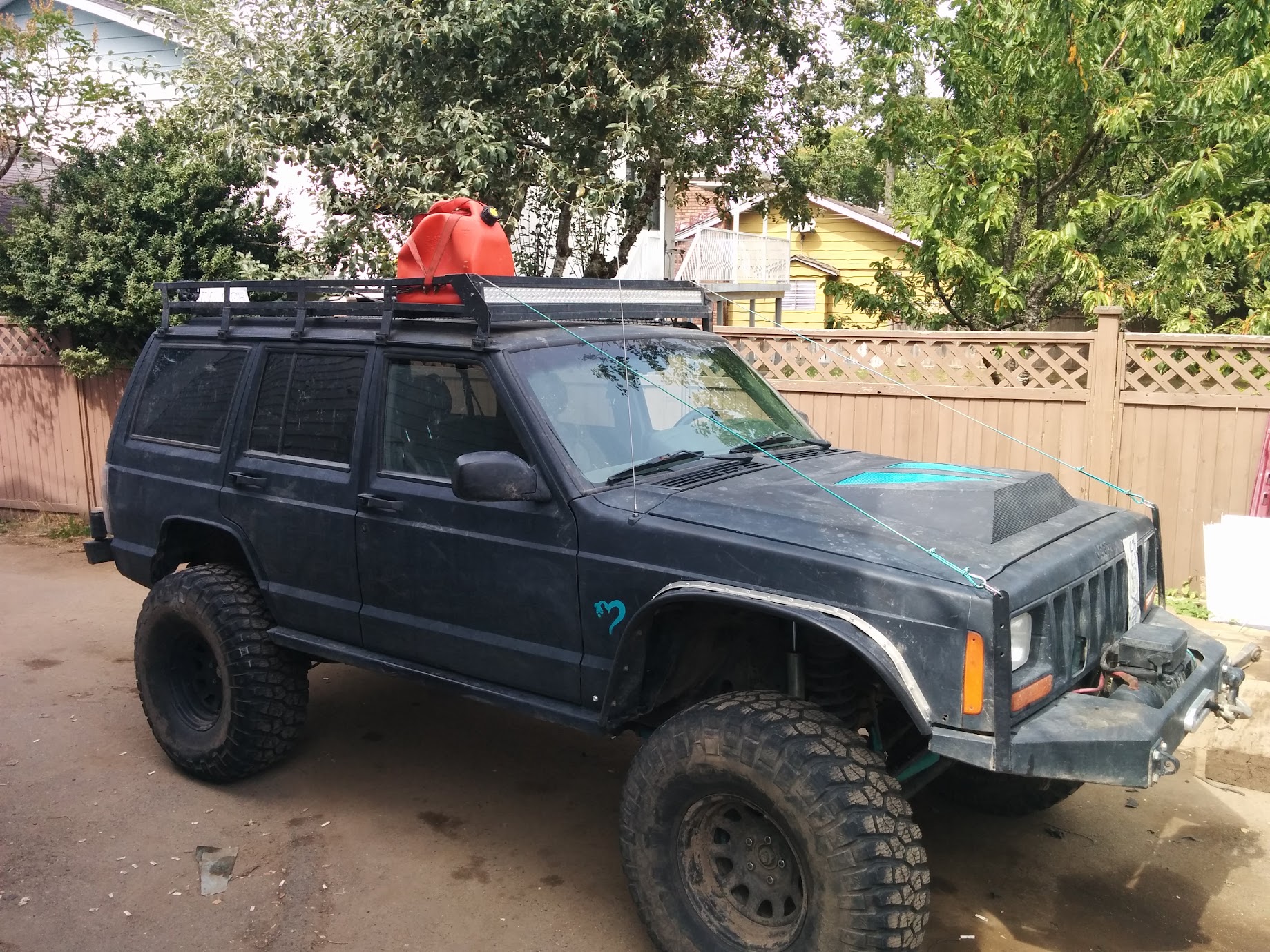

Current setup looks like this:
yXG4tkjUBmuFvb5HMZvSnsTPxkpx-Rn3ue1jkIWi8f-Y=w1839-h1379-no
Yes, I'm aware the silly hood scoop isn't helping my fuel economy, but it IS helping in the whole "having a hood at all" thing, as well as dramatically helps keep the engine bay cool. I may block off the front of the scoop as I'm sure it isn't helping with the cooling anyway, and probably hurts the economy very slightly.

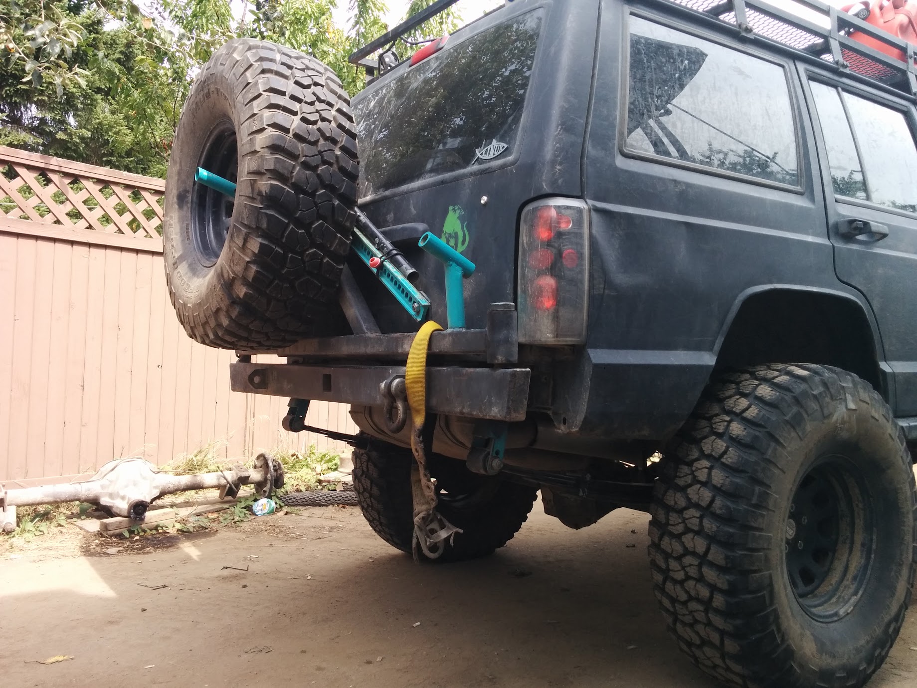

T_FexA4fAeUItZu-Z7nmJEkvnM-PNUn7uxRWLLMksxIN=w1839-h1379-no
LRhxKwo8X4_K1tmH-15a4kaK3SkAZ8YGgqE28ibMu4O3=w1839-h1379-no
Unfortunately, that spare is brand new, while the other 4 are at around 50% so I'm only using it as a "get out of the trail" spare. Can't be run on the street due to lockers. *sigh*.

Dude that spare is out there and not all that high. I can see why you land on it. That mounting for the tire could deffinately go up and slat toward the window. Also mount closer to the window.
Look at crok4x4. I use there bumper and tire carrier. Not sayin its the best setup but it is uber high clearence. I have never landed on the tire.
Yea, when I built it, I built it with the rear shackle mounts in mind. I could've put the tire up higher, but that gets awfully wobbly way up there without a lot more metal to hold stuff stable. If I do end up retaining the carrier, I was definitely going to tip it forward and possibly move it up a bit. I keep holding off on this because I haven't decided if I'm going to cage. If I cage, the hatch comes right off and I build something new from the ground up, in which case I'll have more angle to the rear, and thus a good spot for the spare.
