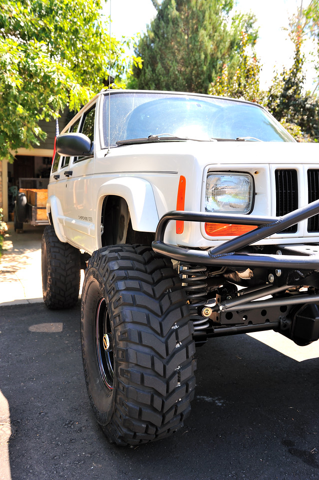

My fenders are limiting my uptravel and they need some more trimming. How high can you go before it starts looking stupid? If I go all the way to the bevel, will the inner fender start showing?

you still have the stock "lip" on the fender? i put down some masking tape and made a jig out of 2 pencils 2" apart... and just traced that outer most edge. relocated the washer reservoir. looked stupid on littler tires... but now with 35s? its about perfect.

37's on here... sorry for the snow everywhere, but this is relatively minor trimming necessary... depending on the bump stops... you can cut up to the reservoir if you chose, also you can re-locate it and cut higher as ive seen... sorta all about your preference. but theis doesnt rub at turn either
