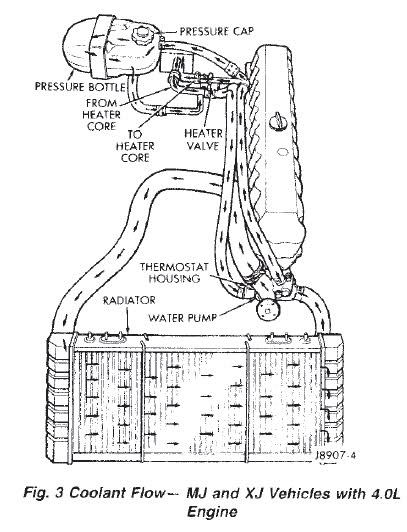

But on Renix, the radiator is a trapped loop with no air exit.
I think the bottom of the coolant bottle feeds the water pump inlet (3/4-5/8 hose) and the second hose by passes the T-Stat (driver's side) and lets hot coolant from the head(?) under pressure from the pump pushing coolant to the radiator then to engine block feed/flow, and then through the head, and then to the heater valve Y that splits flow/diverts flow to the bottle or heater core?
So why does it suddenly blow steam out just as the T-Stat gets in the 180 to 190 F range and starts to open?
I am trying to plot the path of the steam eruption through one of the 2 hoses to the coolant bottle to make sense of how it can do that.

The coolant hose going to the heater valve/coolant tank and the return have a secondary function. It allows coolant to bypass thermostat so the hotter coolant get to the thermostat. That loop helps make the thermostat much more responsive.
Way back in my racing days we'd plug that bypass and had heating issues, the motor seemed to run either too hot or too cold in cycles. We learned to make a loop instead of plugs to bypass the heater. It was most prevalent in the first start up cycle on a cold motor. Just a thought, but I've seen some really gunked up heater valves.
Another thought, if you've replaced the thermostat you can't use the supplied (universal) gasket. The Jeep gasket is the only one that will work, it has a cut out for that bypass.
Just had an idea. It may be that the engine block needs to get to a critical temp, say 190 F +/- for the trapped air and or ( and or trapped coolant from a stuck T-Stat?) to boil and steam up (pressure) thus blowing coolant and steam out of the heater hose on the side of the coolant bottle into the bottle and out the bottle hole top side.
Also now wondering if the bottom coolant bottle hose ( it may not be sealing, not sure yet...., but it was starting to look like it might not be sealing there in the last minutes of the tests) may be letting air into the coolant pump that then pumps air bubbles into the block.
Or the bottle emptied when the T-Stat opened, and drained and pushed air into the block in seconds, that led a blow out seconds later?

I see no way the heater valve could be involved. It is under pressure feed from the coolant pump outlet.
Only other possible path is for steam to go right through the coolant pump outlet to the inlet and back to the bottom of the coolant bottle. With I find highly improbable.
We know there is/was some air in the engine/radiator because we were able to get the bottle to empty as we filled it 2-3 times before the blow outs.
So my plan is to pull the T-stat-Radiator upper hose at the T-stat and heater hose then fill the block and radiator using the Coolant bottle, which has never failed for me. That lets the radiator de-gas fully and the block and head.
