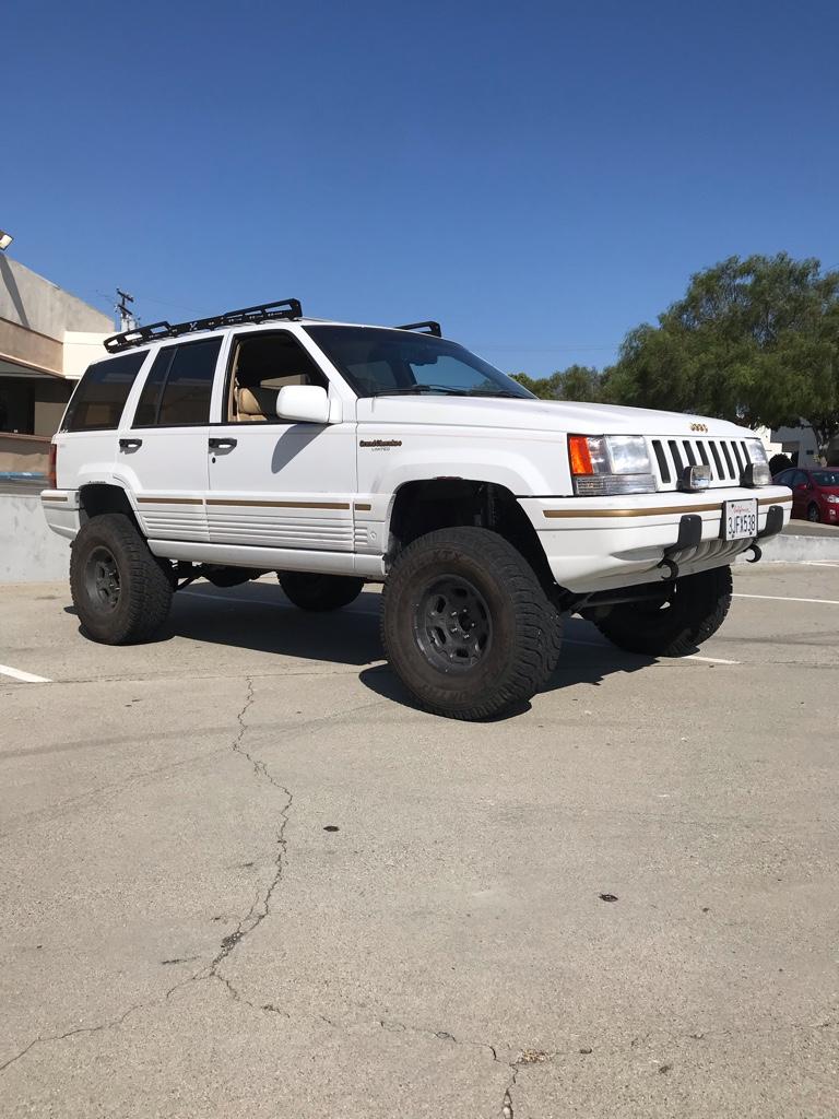

Hey everyone! Long time lurker, but finally joined up to post my new build since it’s a unibody. I’ve got a 94 ZJ Limited 5.2L with just under 67k original miles. I’ve had it for a few years now, and just finished installing a lift on it last weekend. This is my 3rd Jeep and I’m building it to be a go-fast rock crawler, typical SoCal style build. My goal is to keep it clean but capable. As it sits now, I’ve installed the following:

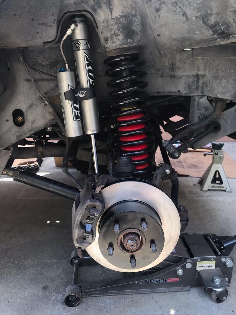

BDS 4.5” coils
Fox 2.0 adjustable reservoir shocks

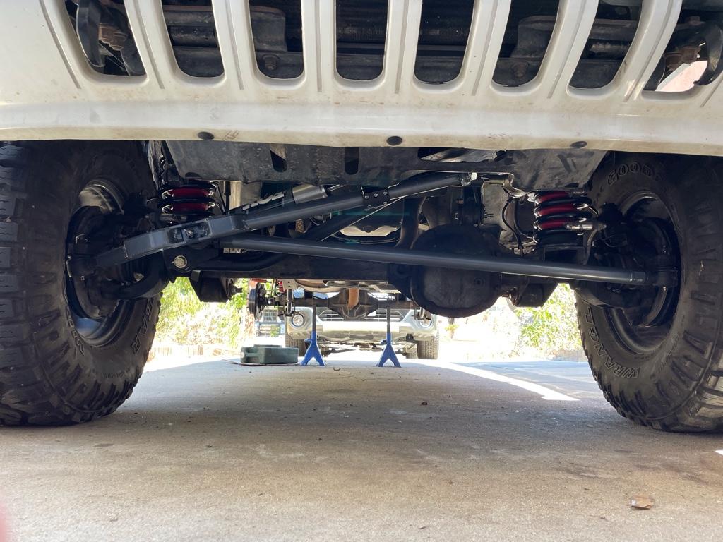

A mix of Ironman4x4 Fab and RC control arms, with Johnny Joints swapped in to almost every end (the front LCA’s still have 1 rubber bushing, and the UCA axle mounts are still rubber for now)
Clayton front/IRO rear track bars

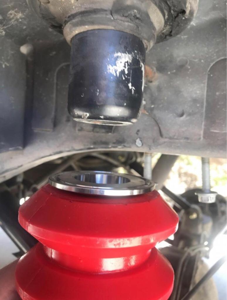

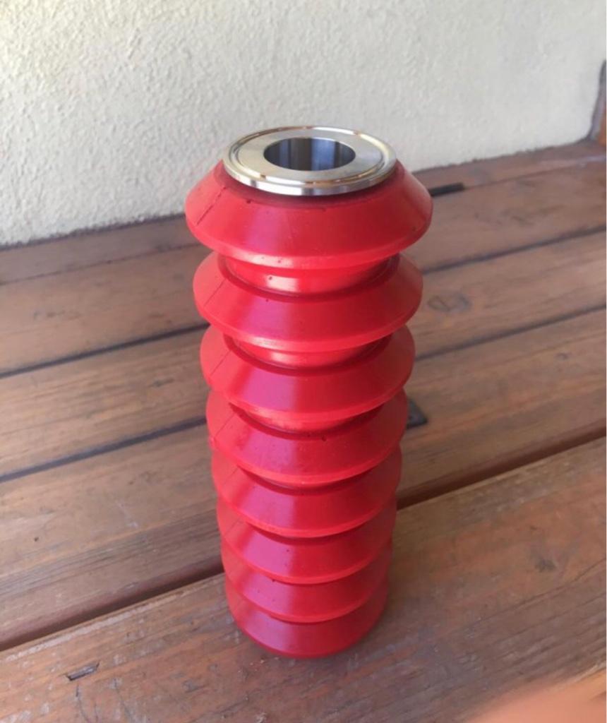

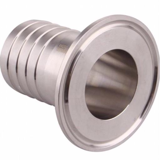

So I’ve ran prothanes on other Jeeps in the past and had issues with them jamming up onto the coil retainer/bump stop post. I found these 1.5” barbed adapters with a 2” flange that fit perfectly into the Prothane. It’ll prevent them from getting jammed, but I’m anticipating the rear to be noisy. The front still utilizes the stock bump stop so it has a soft hit, but the rear is metal on metal. I’ll have to see how excessive it is but I’ve got some ideas to quiet things up if it’s too annoying.
https://www.amazon.com/DERNORD-Bar...uPWNsaWNrUmVkaXJlY3QmZG9Ob3RMb2dDbGljaz10cnVl
