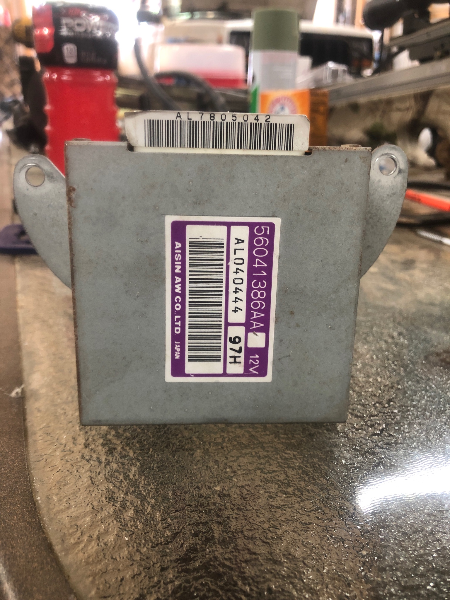

Yes, have done the test, no haven’t verified that I have the right TCU. Going out right now to check it out. Is there a noticeable difference in the 98 TCU and the earlier ones? Or do I have to pull it?

Ok, now I’m more confused. I have a grey plug (89-91)? Bat style TCU bracket (98-01), and a 95 engine/transmission????
Yes, that's a 98 model year TCU, and I believe 97H means manufactured Dec 1997. I've heard a 97 TCU will work and would be the simplest solution. I just looked at the 97 and 98 manuals and confirmed the tcu connector pinouts are the same, minus the input sensor on the 97. You might have to trim or modify the connector if the keying is different but should otherwise plug right in.
I would like to ask you something else before I purchase a 97 TCU ( I have dumped a lot already, and no better ) I understand that the 98 TCU doesn’t understand what is going on, and will cause my CEL, but would it not recognizing the output shaft speed sensor make the tranny take awhile to engage reverse (at idle) (can give some throttle and it will speed engagement up) forward seems to hit on time? Or do you think I probably have a tranny laying down? Don’t want to get a 97 TCU, loose the CEL and still not have a good reverse. It gets really bad when it warms up.
