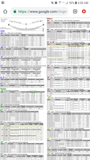

Suspension you are prob going to need to do a custom leaf order or do an add a leaf and XJ coils (same as MJ)

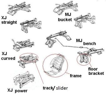

Buckets for the MJ use different sliding rails than XJ but the seats themselves are the same 87-94. Whatever you do, hold nto the bench sliders as a just in case since they arent manufactured and only for our trucks.

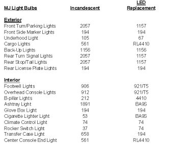

Mods done sooner would be the LED interior lights. IDK if anyone sells them because the guy I bought mine from closed down shop. LED headlights are also up there on the to-do.

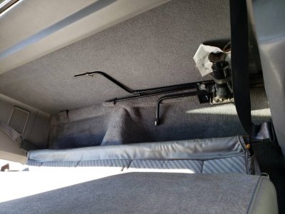

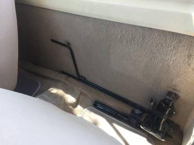

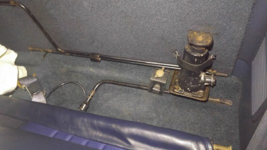

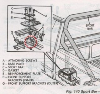

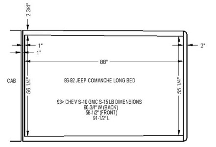

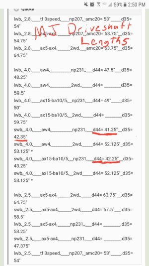

Here is a bunch of MJ specific pictures that I have amassed over the years that are not FSM pics which are not allowed to be posted. hope this helps.
