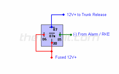

My first thought was attaching a normally closed relay to the yellow line and attaching the relay to my rock lights. Not a bad idea having the lights on their own relay. The problem I have is that the relay will have to be energized the entire time!
I'm going to keep digging around. I switched my major from electronics to computers in college. I wish I had more electronics now! I was hoping for a 12 volt on signal from the RKE, instead I have a 12 volt on and a 0 volt to turn on the dome light!!!! arg....
I purchased a standard automotive relay. It will switch 12v if the relay is energized, or off. Basically I was going to hook up the relay to the yellow wire, but use the post on the relay that switches the 12v when the relay is off.

Ok I'm an idiot. I think a "normally closed" relay would have 0 current drain... More to come...

Yep, I found this one just after my last post. It is almost identical. I was considering running from both the yellow and red wires, but after your suggestion that is what I will do. Thanks!
The only thing I am going to do in addition is put in a diode so when the coil distarges it won't fry the RKE.

good call on the freewheel diode. i fixed the schematic for future reference.

Done, and in the bag. One thing though. You don't switch the 12 volt, you have to switch the negative line.
So just like the drawing above but connected to the chassis ground and the ground for the LEDs.
LED rock crawling lights now come on as does the interior dome and foot courtesy lights when you press the UNLOCK on the remote.
The LED rock lights also come on when the door is opened.
The switch that I installed to turn the LEDs on and off (and flash) still functions.
