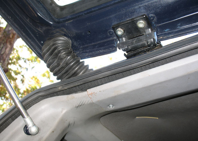

Here are some pics that show the difference between the two sides.
Passenger side, this is the side with the problem. The gap is large between the body and hatch, also the hinge sticks out past the body more that the hinge on the drivers side.
Drivers side, Small gap
