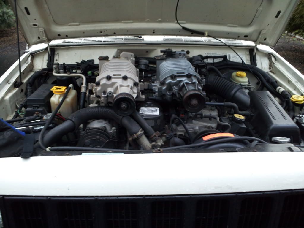

Yes. This is what I've been working on to keep me busy while I wait for my big valve race ported head from 505 Performance to get here so I can fix my red Sprintex Jeep... Lol

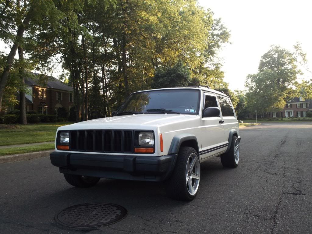

Bone stock. All I added was the tint.
Just playing around with a couple blowers.. Ended up just being flame bait. Lmao.

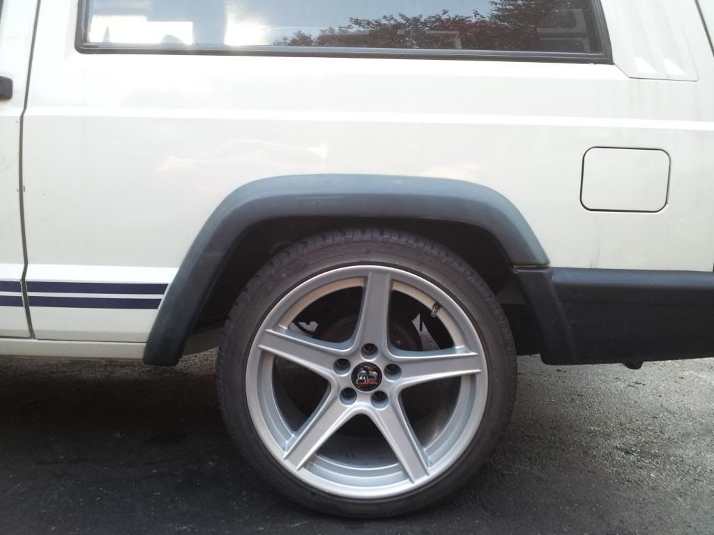

18x10 Mustang Cobra reps with Nexen 265 35 r18 tires.
With them on... NEEDS MOAR LOW AND MOAR POKE!!!
Therefore, spacers..

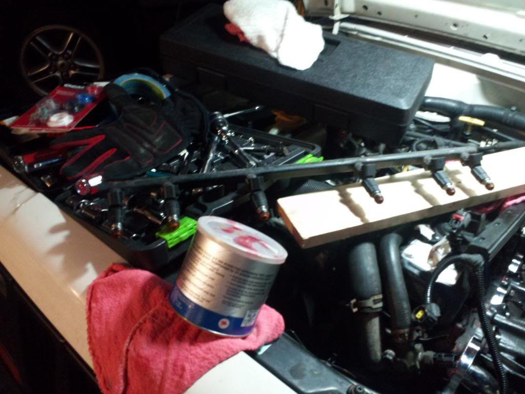

784 (i think that's the right numbers....) injector install

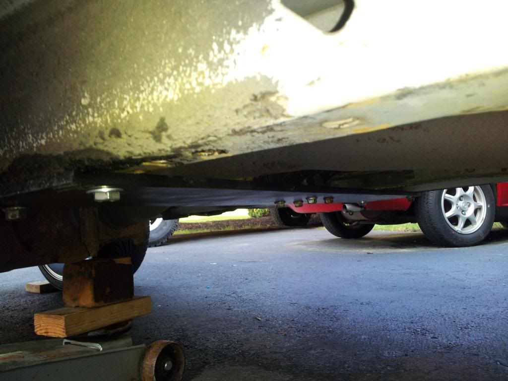

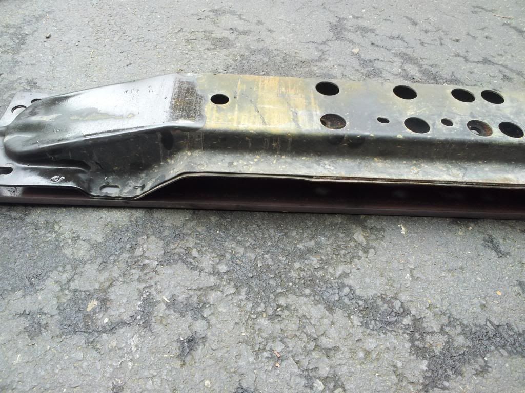

Working on making a "flat" transmission crossmember out of 3/8" steel.

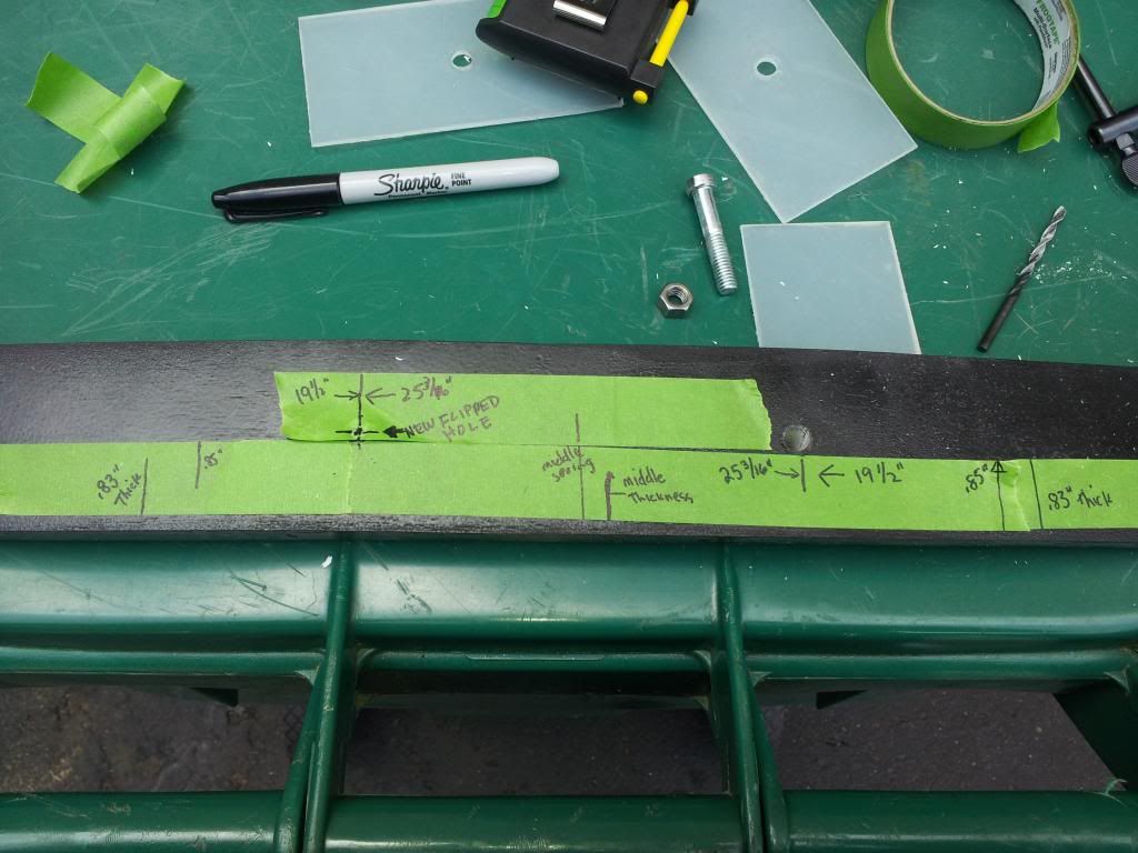

Drilling a new centering hole in the fiberglass monoleafs

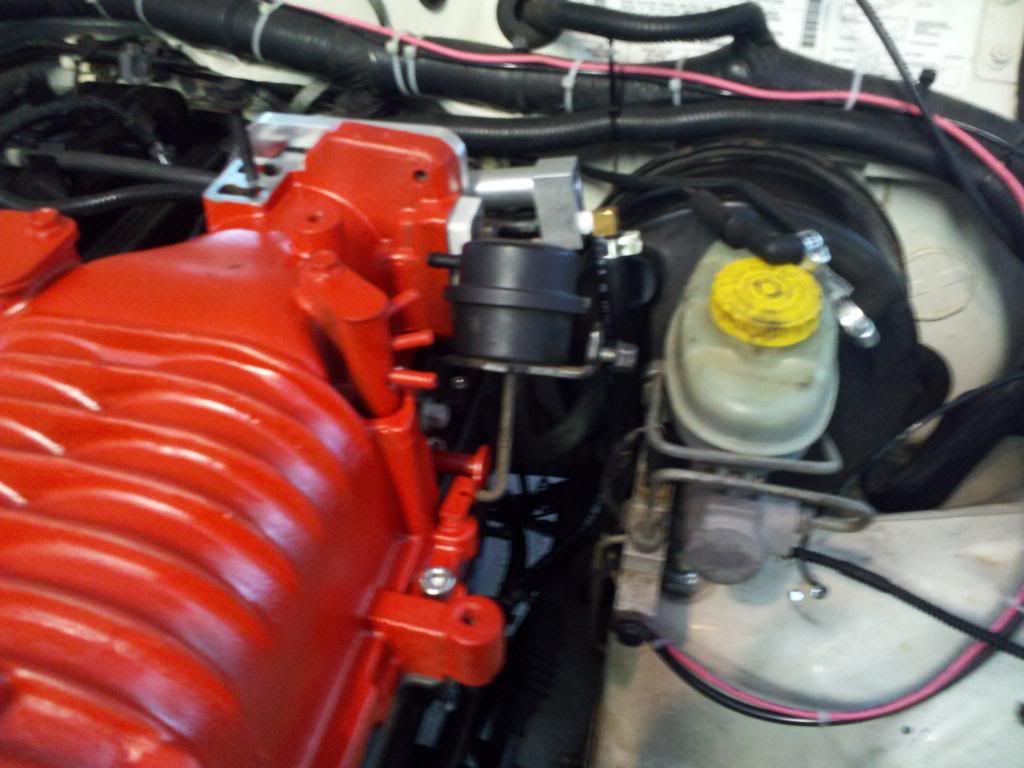

Piggyback for the supercharger. 100% plug-and-play.
Ended up adding a second fiberglass monoleaf to firm up the rear end. Something like 475lb per inch for each spring now.

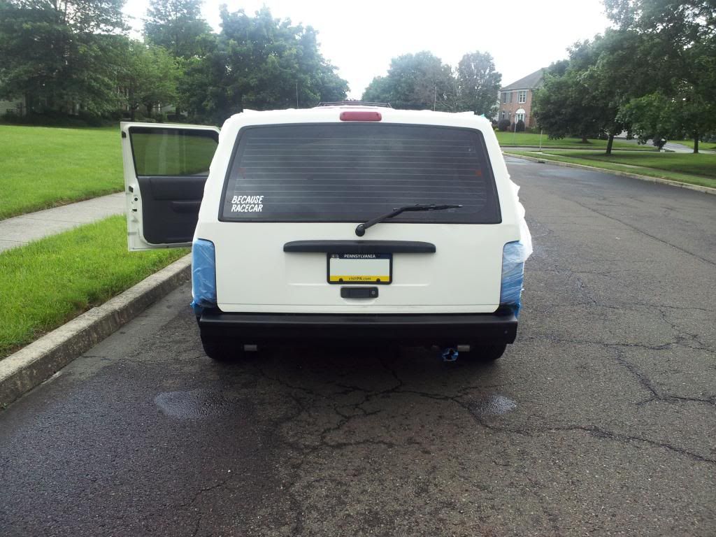

Okay. It's officially a racecar now.
Repainted the rear bumper again and... It stated raining five minutes after I finished... %&#*%W$#&

Mount piggyback
Plug-and-play

Fixed a little problem with the bypass valve actuator so now it holds full boost. Holds at around 6.5-7psi and the AFRs look great. The only thing it needs now is Meth.
