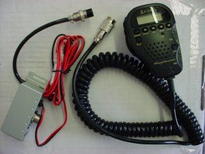

Sure you can't boost the power on it or anything (so far as I know) but I think the Cobra 75WXST is great given the limited mounting space in our XJ's. You just tuck the little box behind your dash or under the carpet and hang the all-in-one mic wherever you want it. You don't get some of the fancy features that the big box units have, but it is more than enough CB for group trail rides.

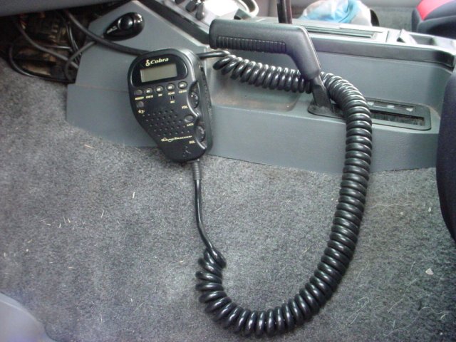

It was funny how many pictures of installs in XJ's I found while trying to google a picture of it. I mounted my mic next to the gear selector, but you get the idea...
