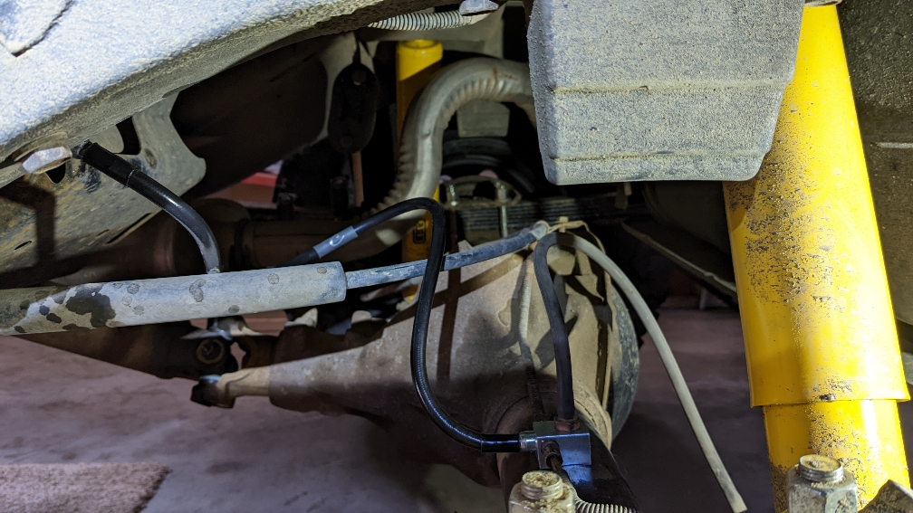

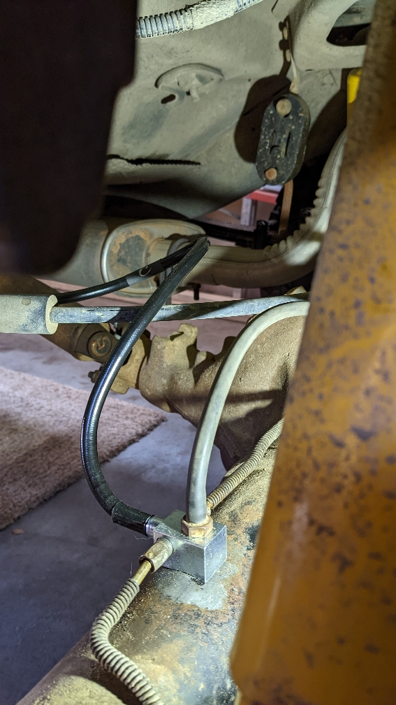

I was able to get it installed and I think it might be ok. How does it look to anyone with more experience
Not ideal, but it’ll be ok most likely.
Could you bend the support tab up, and add an adel clamp on the soft line along the frame? Should eat up some of that slack?
Get a long spring. Run a few layers of eletrical tape then tape spring to line drill hole somewhere to run spring to.
To much is always better than not enough.
