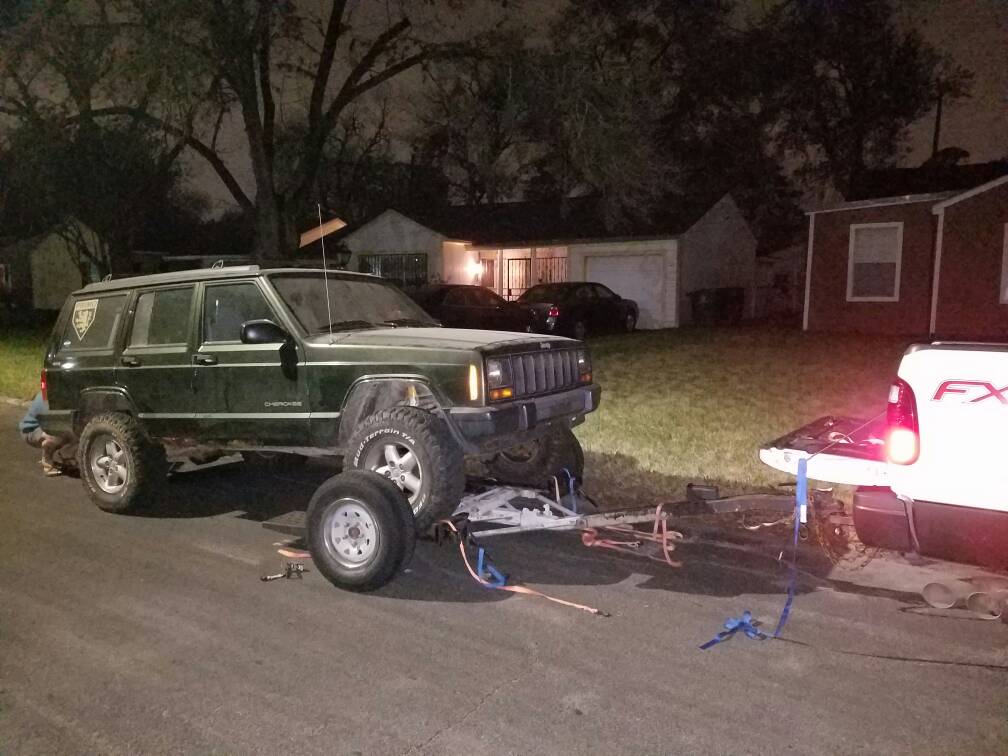

Hey everyone! I'm the FNG down in Hutto. - I bought my '97 4x4 about 3 months ago and have been going through it's maintenance. It's in solid shape, aside from some surface rust on the undercarriage. Below is a picture of it the night we picked it up in Houston.
