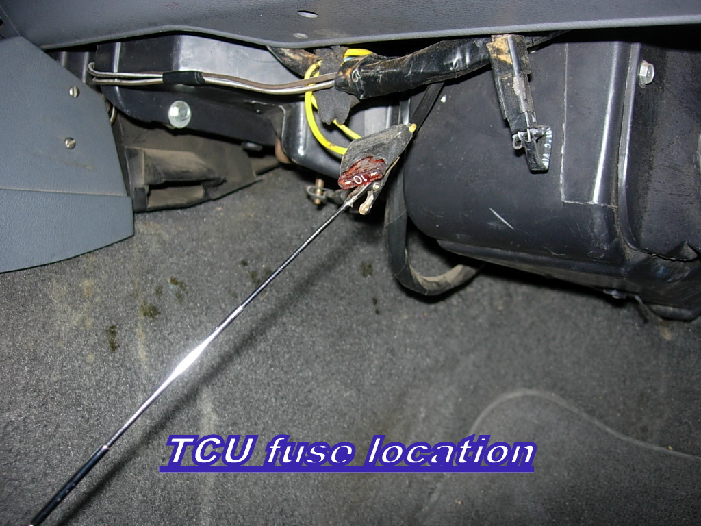

I put another transmission in the XJ. It runs great now if I shift manually. However, ITF I start in D, it seems to start in 2nd or 3rd gear. Not 1st. I tested the harness to my TCU and I'm getting battery power on pin D14, but not getting power from the ignition on D16. I can't find a fuse that would be protecting that in order to test either. Any suggestions?
Not sure what was the last year of this stupidity, but the older Jeeps had a fuse in the wiring harness near the TCU.
