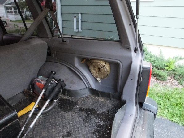

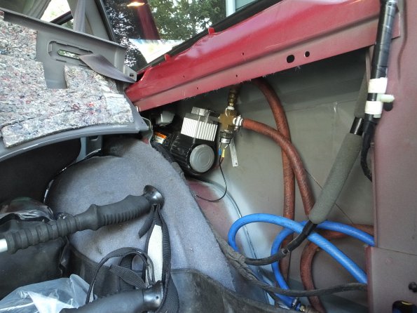

Here is a picture of where I mounted mine mini ARB compressor on my 2000.
I have been thinking of trying to mount such a compressor inside one of those quarter panels. If you remove the interior panels you will find there is quite a bit of room inside. I like the idea of down low, in the section between the wheel well and the tail lights.
I think a couple of pieces of 1/8" angle iron on each side would provide a ledge on which a mounting plate could be supported. A better job could be done if you have access to a press brake. Bends of something along the lines of 100 degrees are probably more in line with what is actually needed.
The mounting to the outside body panel will be the sticky wicket for most folks. The nut strips for my armor were the catalyst for this idea for me. I already have hardware running through the body there.
One thing to make sure of first is the sealing up of the cavity to the outside of the vehicle. There are a couple of plastic body plugs that if missing will allow a phenomenal amount of dust into that cavity. I was missing one of those plugs on one side and the dust had accumulated to the point that it was a couple of inches of dirt. That amount of dust is not going to be healthy for a compressor.
Just a thought for your consideration.
Mines mounted about where Jeeptec's is!
