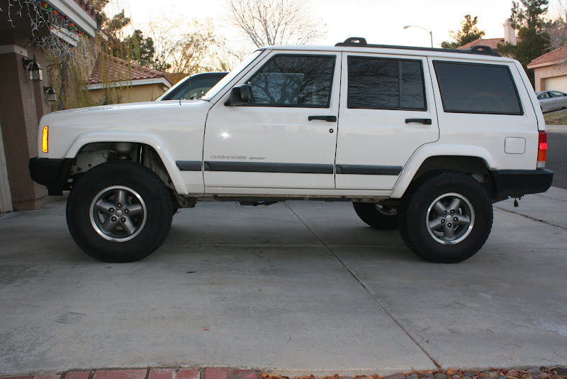

I have a 1999 XJ with a 4.0L engine, automatic, NP231 transfer case, Chrysler 8.25 rear axle, and a new 3 inch budget boost. I am a noob. This post is for other noobs who are in the middle of a budget boost lift or still trying to figure out how to do it. I am sure that there are better ways to do it but I know that this works because I did it and it turned out great. It rides firmer than stock but is still very comfortable. It doesn’t squeak or rattle. It is taller so it does not feel quite as good cornering but it still feels safe and sure footed.

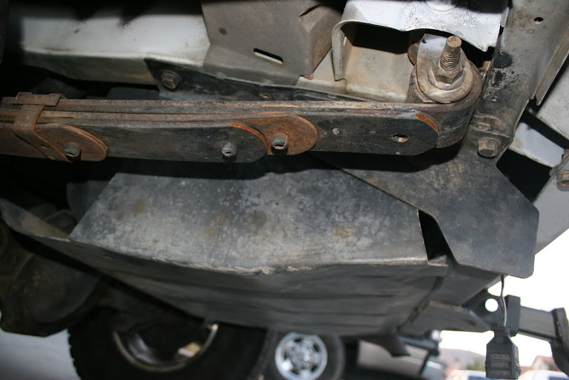

I must work slow because there is no way I could have done this in a weekend even if I didn’t run into trouble several times. The first problem was drilling the holes in the leaf springs to add the anti friction pads. This was a pain and the drill bits are expensive. First I used a ½” cobalt bit. I got through 1½ leafs before it died. So next I used a masonry bit it lasted 2 leafs so I had to get one more masonry bit to finish the job. I tried putting the anti friction pads in the leafs but they would not fit so I filed the posts on the pads down until they fit.
The next problem was when I tried to remove the upper shackle bolts the steel sleeve in the shackle bushing was rusted to the bolt. It ended up pushing through the outer shackle bracket on the frame and made the hole bigger. I had to weld in a washer to make the hole the correct size.

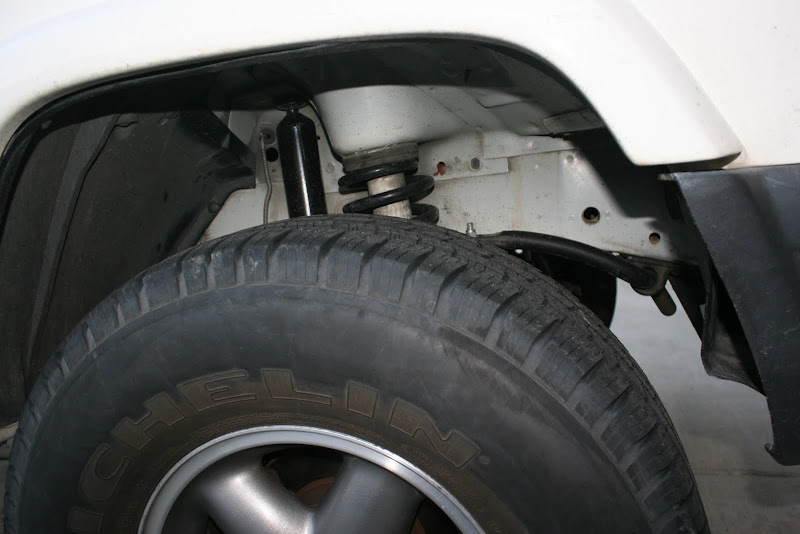

When you go to the parts store to borrow a coil spring compressor make sure you get the strut compressor. The coil spring compressor has a fork that goes through the middle of the spring to compress it. On the XJ the bumpstop gets in the way. While my front coils were out I did remember to drill and tap the spring base for hockey puck bumpstops.

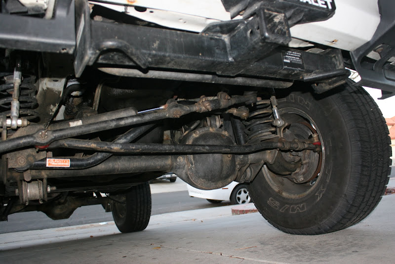

So now the lift was in. I took it for a drive and had terrible Death Wobble at 35mph. I made shims as described by GoJeep and aligned it per his direction. Things got better but at 55mph I still had problems. Everything felt solid in the front end. I searched the forums for solutions and found posts that said to get under the front end and look for loose parts while someone is moving the steering wheel back and forth. I saw some movement, about 1/8”, in the track bar so I replaced it with an adjustable track bar. The new one did not fix the problem and it still had the movement. It did center the axle though. I really wasn’t worried about centering the axle because it was only off by about ½”.
I was talking to a friend about my woes and he had similar problems in the past. He used a small pry bar to look for worn font end parts. He explained that with the springs in the front end everything is so loaded you can’t feel some of the things that may be loose. He came over and we found a couple of control arm bushings that felt loose with the pry bar. They felt fine when I tried moving them by hand. I replaced the bushings and the Death Wobble was gone.

The lift was about $327. I have spent more money on other things though. The Homebrew SYE was about $125. The track bar I didn’t need was $147. Nuts and bolts and drill bits were probably another $35. I spent $200 on a set of used 31” tires.
I installed a ZJ (1993-1998 Grand Cherokee) tie rod. It is so much bigger and stronger. The adjusting collar was pretty close to a bracket on the axle so I got out the angle grinder and took care of the bracket.

When I flexed it I was hitting the front bumper end caps so I cut them with a utility knife. It was easy, I just followed the line left by the mold when the end cap was made.

Congratulations... but why did you need to remove the upper shackle bolts to add leaves to your spring packs?

As I recall the trailer hitch was getting in the way of removing the the lower bolt. Once the rubber in the shackle tore It had to come out anyways. I got 3 inches with the spring and about 1/2" with the shims. I ended up with a 6 deg shim and a reversed 2 deg shim for a total of 4 deg.

As I recall the trailer hitch was getting in the way of removing the the lower bolt. Once the rubber in the shackle tore It had to come out anyways...
Ok... but why would you have needed to remove the lower bolt just to add a leaf or two?
Didn't rocklizard's write-up recommend against removing the springs, for that very reason?
