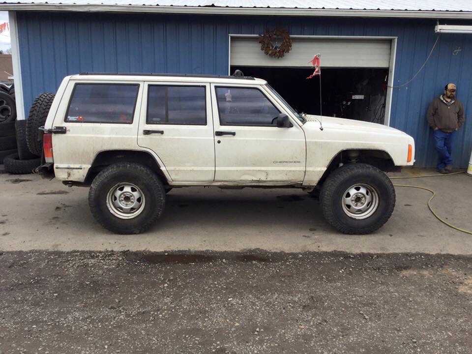

This is 33" and 3.5" lift.
While yes my front fenders are trimmed and rear is cut and fold, yours should have no issue with a little bump stop and trimming
