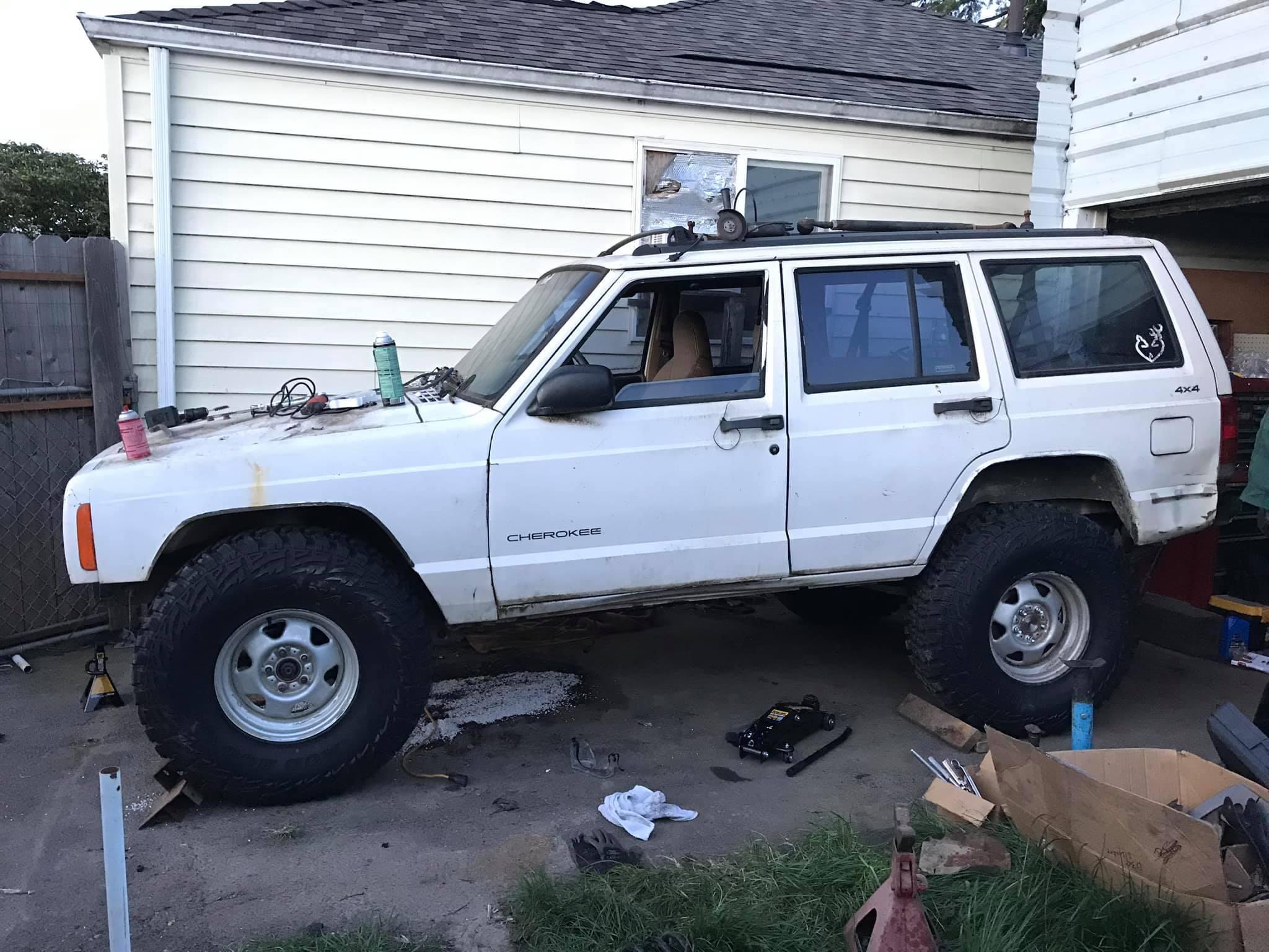

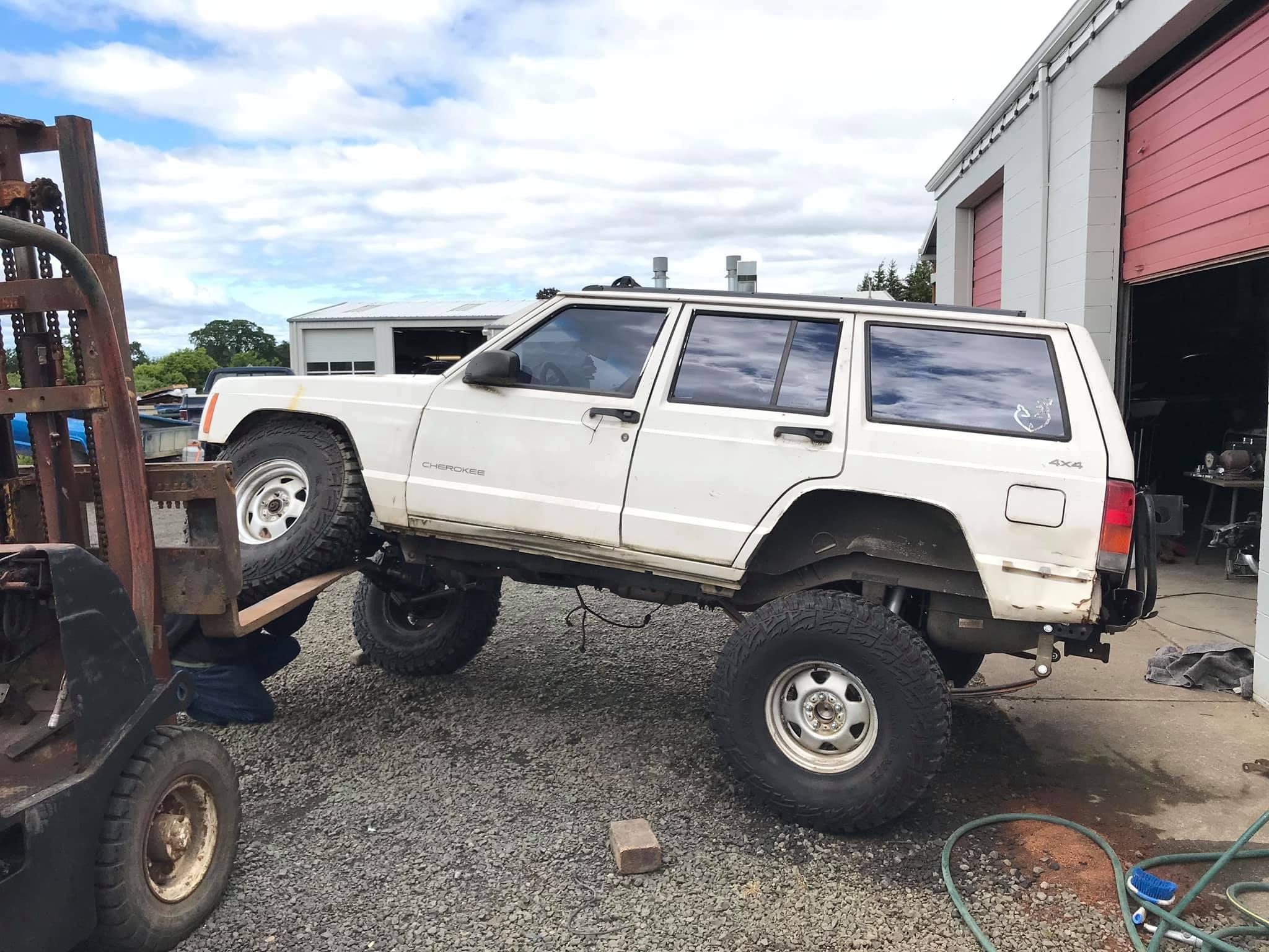

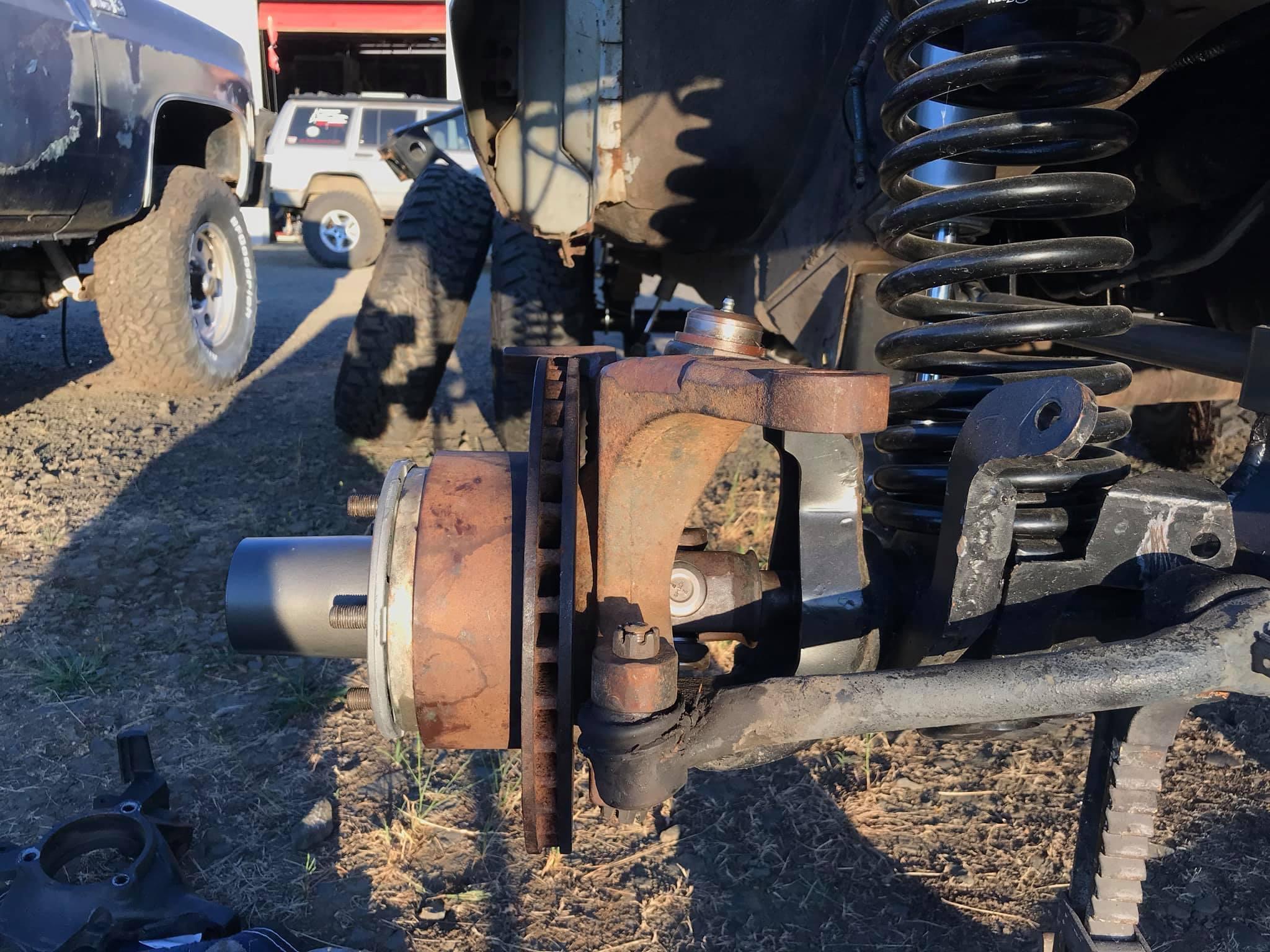

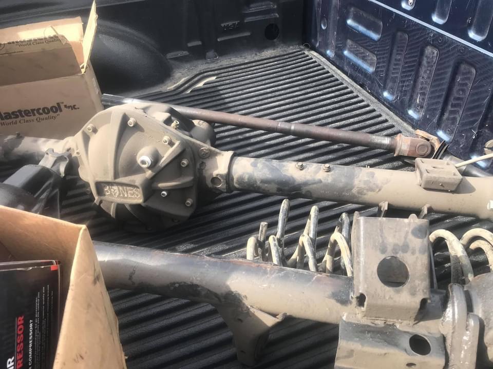

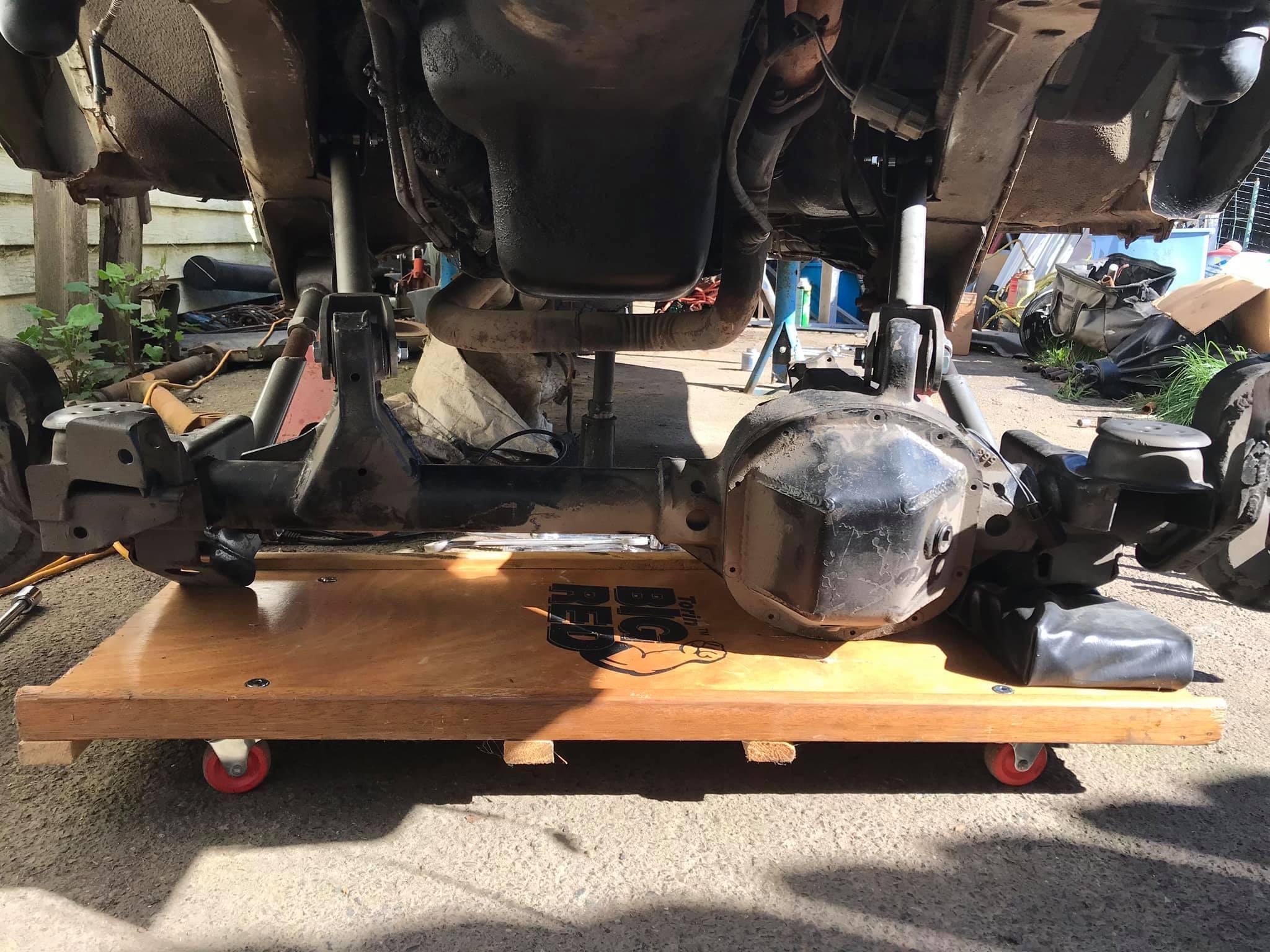

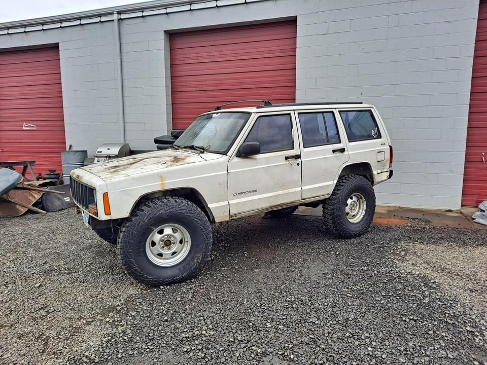

Well hey you Guys I’m back lol ish. After taking a very very long hiatus because of family and work, I’m getting my Jeep finished finally. Been a long time coming, some didn’t think it would happen, hence why I never set a finish date, leaves wiggle room for days, weeks, months... years.........😬
Just a refresher
-D30
4.88 gears
Chromos inner and outer shafts
Spin free warn hub kit
Ruffstuff diff cover

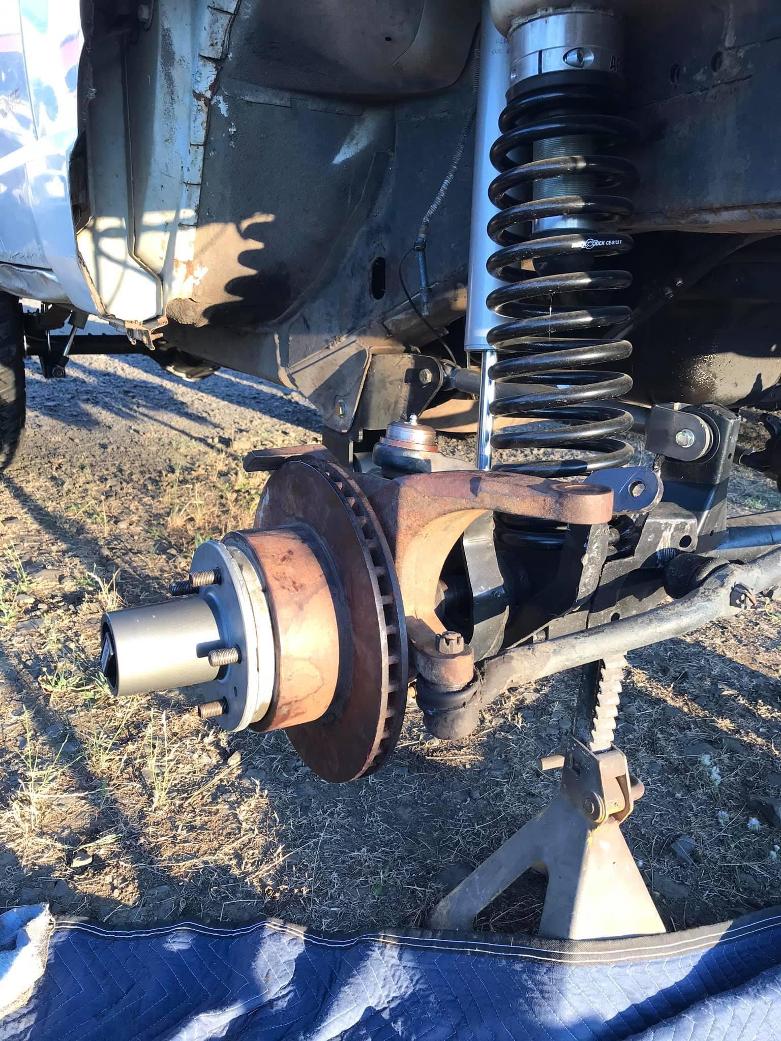

Knuckle gusset/control arm boxed
E-locker selectable locker

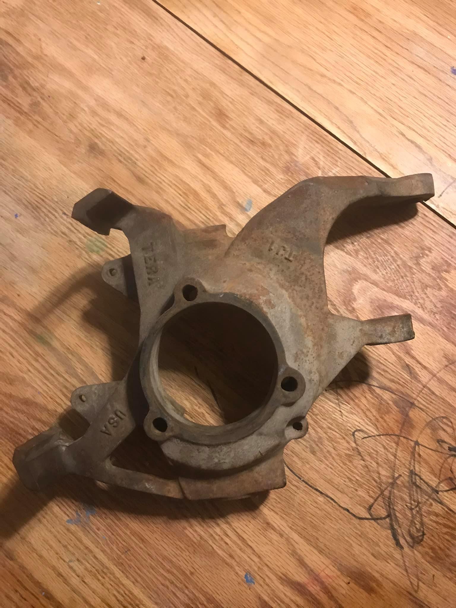

Teraflex high steer knuckle

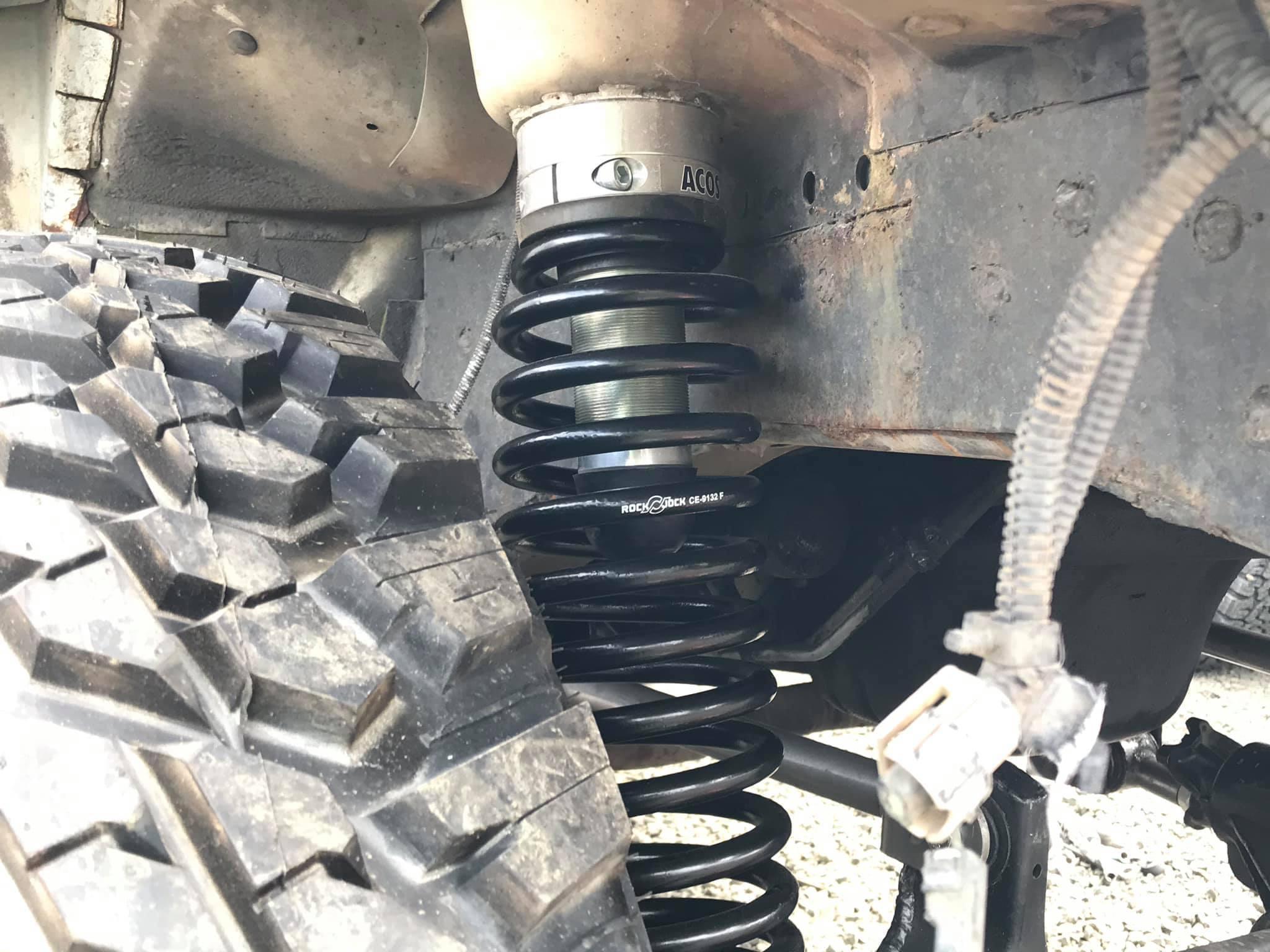

Currie 4” coils
ACOS

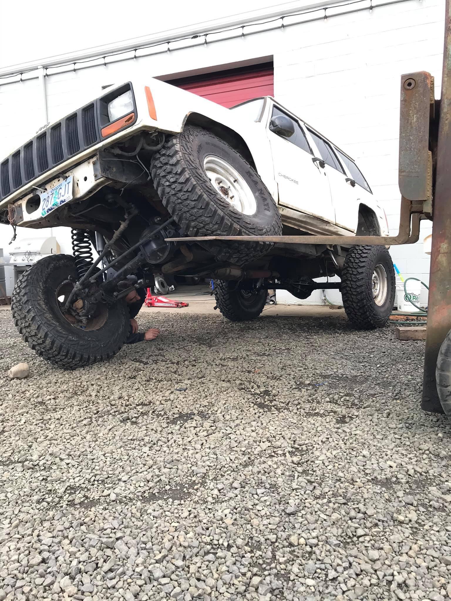

Full traction SRS adjustable control arms
Drop brackets
-D44
4.88
Zip locker selectable
Chromo shafts
Disc brake
Bones custom HD diff cover
Shackle relocators
3.5” leaf springs (I think)
231 Tera 2Lo
Sye

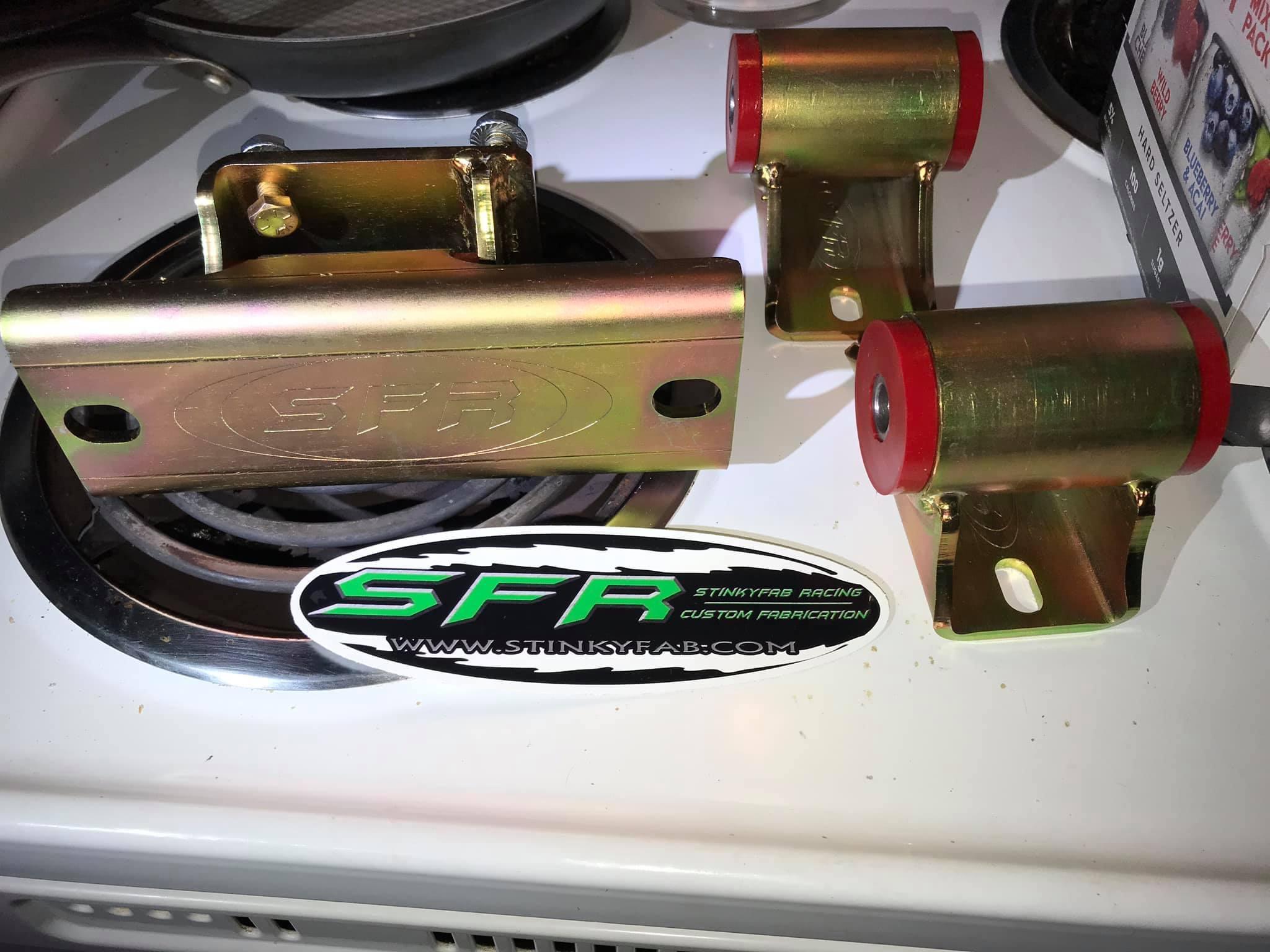

Stinky fab motor/transmission mounts
OR fab winch bumper
Warn 8k winch
35/10.5/15(yes 10.5 wide/pizza cutters) mud hogs
Hydro assist
That’s it for now, hoping to get back out and wheel with you all this summer

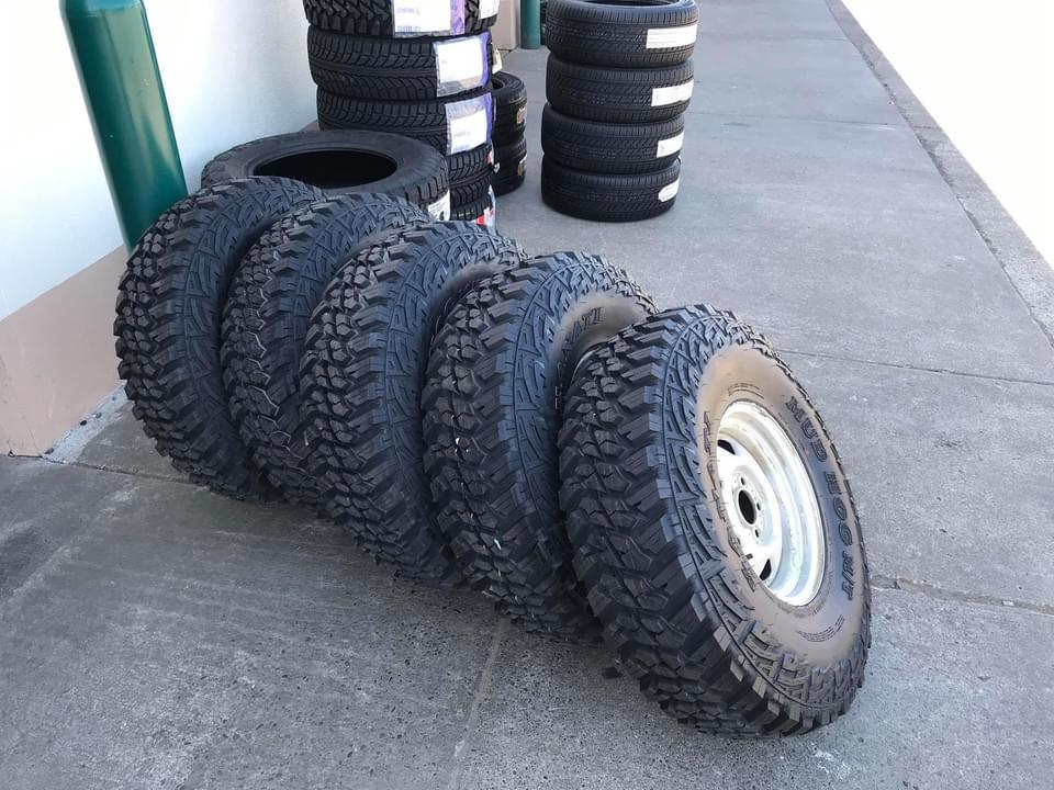

Looked at Kanati's Mud Hogs. Are there other tires in the 35/10.5/15? Or even 16?
Here’s a their link
https://www.greenballtires.com/brands/kanati/mud-hog-mt
You’ll have to look through but from what I saw they have a 16” buts it’s comes out like a 35/12.5.
Maybe their A/T might have one? But from what I can see, the mud hogs are pretty good. Daryl at JCR runs them and has said good things about them so that was what got me to jump on them, plus I’ve been searching for skinny 35” forever.
Here’s a their link
The 35s in 15 and 16" are both 2-ply sidewalls. * next to the part number.

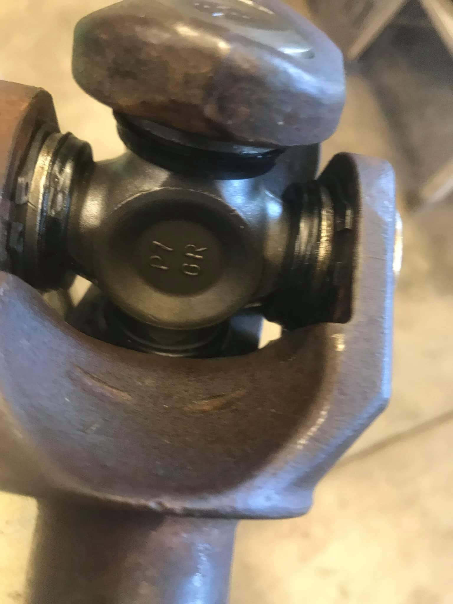

Just a update, almost finished. Need to build brake line for the rear axle, hook up the front and rear selectable lockers, swap out the strap style d30 pinion yoke for the Ubolt style, and get the temporary steering set up on it. Later I plan to utilize the teraflex highsteer knuckle for high steer and hydro assist but for now I’m gonna run stock style till I get everything finalized
