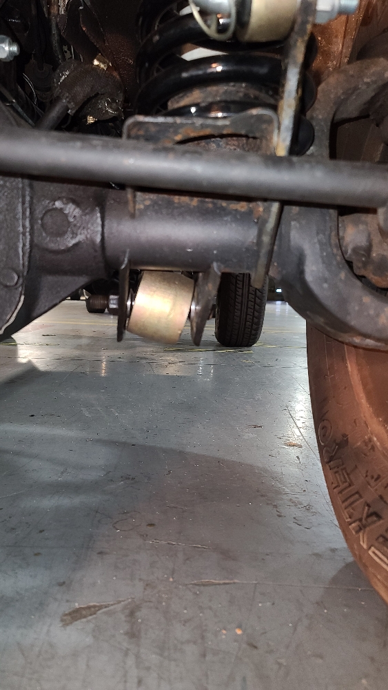

A few months ago I purchased a Rustys long arm kit. Once I received the kit my family received news my wife has pancreatic cancer.
So instead of installing the lift myself (which honestly I wasnt that comfortable with anyway but I was going to give it a try) and now with this news I decided to take it to an "offroad shop" all the reviews I saw were positive so I dropped it off in Oct with the lift kit.
I finally picked it up this week and its all jacked up. Driving home from the shop it had death wobble a few times. It would happen over 60mph when I hit a bump. And would not stop until i got below 35. If I say under 55 it rode fine.
I knew just by looking at it things were wrong at the shop but after 3 months I just wanted it out of there.

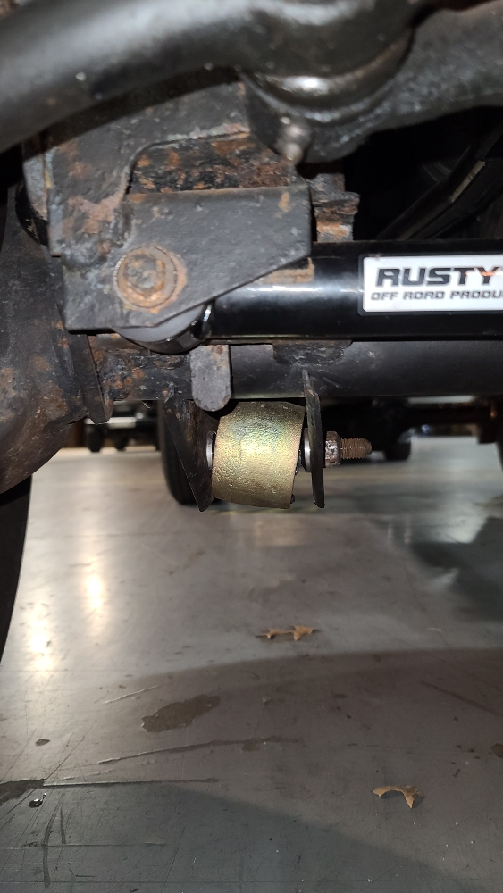

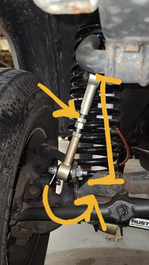

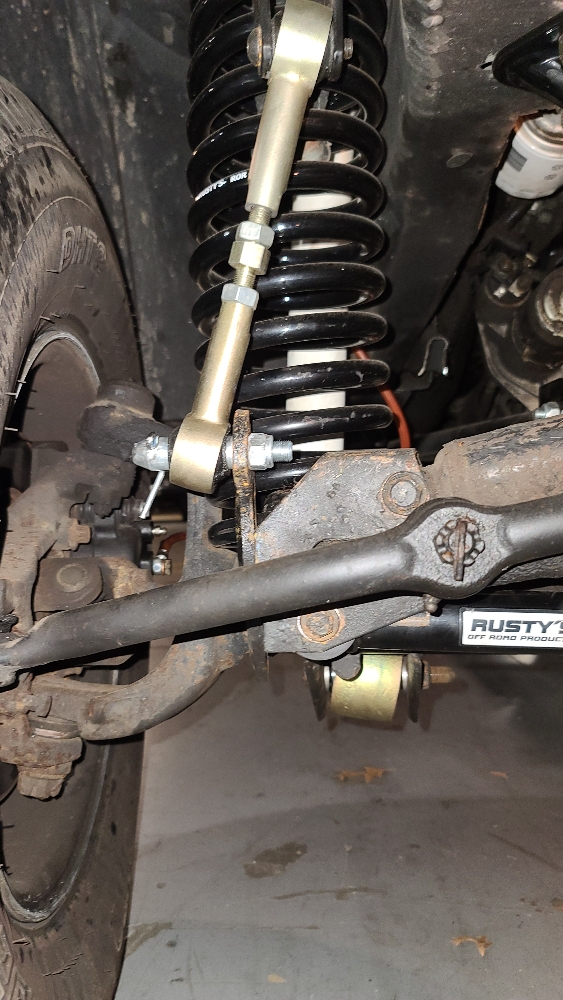

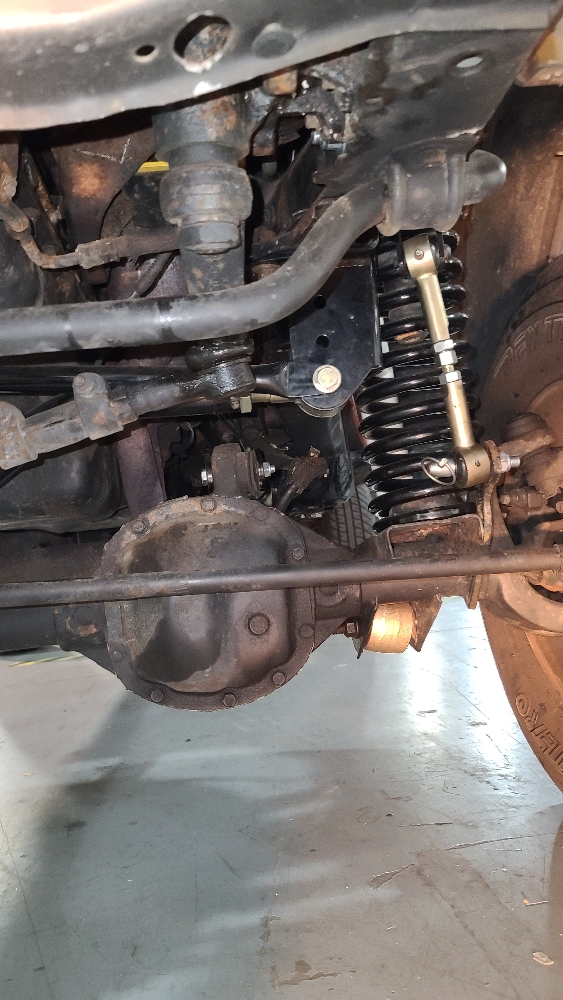

Every bolt in the suspension was loose. Jam nuts on long arms were not tight, track bar bolts were loose, the bolts that held long arms to the axle were loose. The angles on the contol arms look off. It looked like they test fitted everything with the intention of going back and tightening everything up and just forgot.
During the 90 mile drive home i lost 3 lug nuts off the front tires and 2 more were almost off.
Nothing was installed correctly. Even simple things like swaybar quick disconnects were installed wrong and were different lengths.
They installed a sye and now it wont go into 4low i assme the linkage needs adjusted but I havent even looked at it yet.

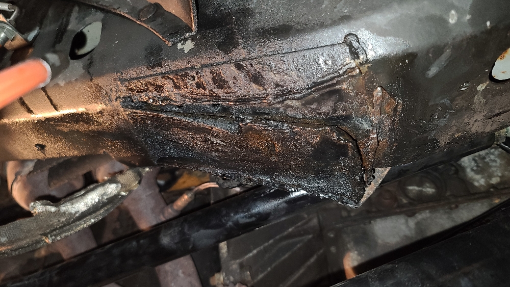

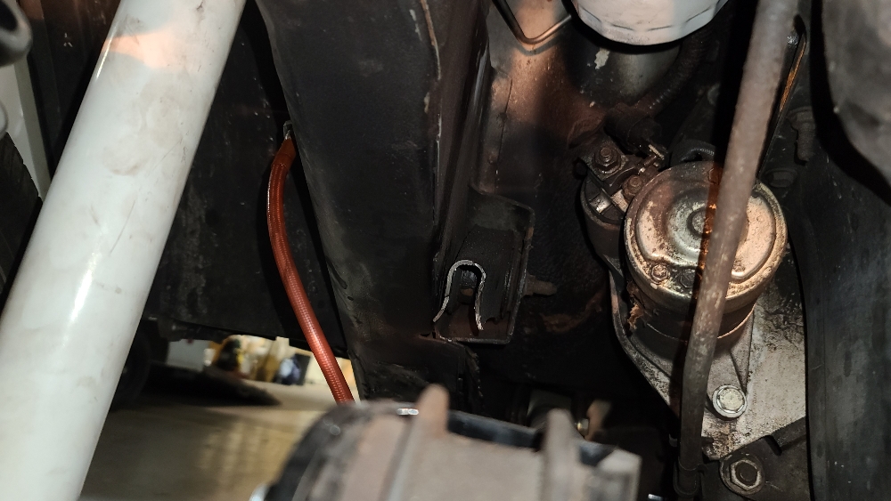

When they trimmed the inner fender well they cut the washer fluid bottle some how it had a steady leak until it ran dry.
That doesn't even include the fact they used it as a shop vehicle and left me absolutely no gas. The jeep started sputtering as i pulled into the gas station that was less than a 1/2 mile away. I found receipts and papers from napa dated after i drooped it off and for parts i didnt need in the back.
So long story short i went through and fixed what I believe to be incorrectly installed and tighten everything down.
My question is short of going 65 mph and hitting bumps is there a way to check and make sure I cured the death wobble issues?
I attached photos of how I got it from the shop.
