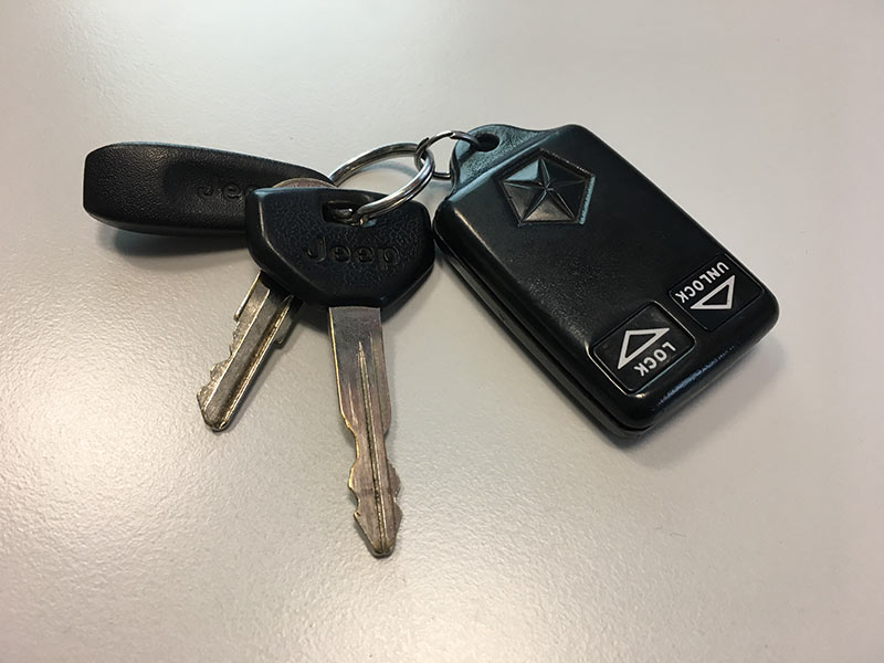

I have a 1997 XJ 4.0 limited with the engine immobilizer. Attached is the photo of my key fob.
One might suppose there is some sort of wiring issues that cause this effect, however failure of the remote keyless entry receiver module does happen.
