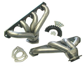

Is this a header or manifold?
mcbrado
MN
http://www.ineedparts.com/index.php?target=products&product_id=15343
I've heard these APN header/manifolds mentioned on here as headers, but they're listed as a manifold and I called and asked the company and they said that it's "a manifold shaped like a header for strength" and that it won't affect my gas mileage.
I thought i understood the difference between the two, but this threw me for a loop.
What's the benefit of getting this APN rather than a cheaper manifold such as this? http://cgi.ebay.com/ebaymotors/ws/e...0ffd80f4a&rvr_id=&ua=WVF?&itemid=310175938624
header/mainfold--Which is it and why?
Thanks in advance

tomcat, That's what I thought the difference was too. clearly, one is much cheaper to manufacture and doesn't have the thought put into it for efficiency, while the other is more streamlined. Ah well, I ordered the APN header/manifold and am looking forward to installing it, even if I don't see any increased performance.

An exhaust header is a manifold design that incorporates individual tubes tuned for a specific performance characteristic, and end in a collector pipe. The pipes ideally are all the same length and diameter. Lenght determines what scavenging characteristics the manifold has, and at what RPM range.
The manifold in the OP's post, is exactly what the manufacturer claims it is, a tubular manifold. The pipes are not tuned to any specific lenght, and it likely doesn't scavenge any better than the stock tubular manifold.
