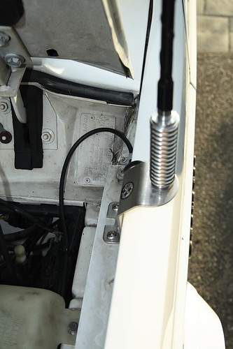

First I installed the antenna mount, I decided where I wanted the antenna to be (as far back as I could) keeping in mind how accessible it will be to get a drill in and where the Coax cable will be going. I came up with this little location...
^ You can see in the photo the mount is attached to the bottom and side of the panel, you have to drill these holes (the bottom ones are a little tough...its 2 panels) but the screws go right in for the most part.
