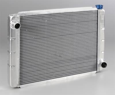

Im not done yet. But I chose to sell my Xj steering box and ram and go full hydro to fit a larger 27X19in aluminum radiator from summit $169. The Becool Xj shape radiator was like $650 but in my oppionion would hold up to a mild 350.A local buy did that for his swap.

If you have any more pics I'd like to see them. What kind of hydro setup are you planning on? What was the part # on that radiator? I couldn't find the one you were talking about...I don't think I could fit that one i mine anyway, though with all my reinforcing. Thanks for the info :)
~Charlie
$169,
Dual 1in core, aluminum, chevy style Drivers side High.
SUM-380328
27.375X19in
I bought a steering valve from a local forklift salvage yard, I have a cherlyn 211-1035 valve, it has 7.3cuin/rev displacement, open center, not loadreactive. A 2.5inX1.25 double ended ram would be ideal and around 4 turns clock to clock, but a single ended 2inX1.125 ram is my choice for now, easier to mount and lower cost, and I can adapt it to my old hydro assist setup.

$169,
While I appreciate all that, I don' think I understood a lick :p Thanks though. I'll probably just go with the hydro-assist. I'm not going to be doing all that much off-roadin'. Do you really have to drop the steering box to put that rad. in there, though? That's a bummer...
You can do like C-rok did and move the steering box below the frame, but yes the steering box is on the inside of the frame rails so it limits the size radiator you can fit. with the steering box a XJ shaped Aluminum radiator would be best but not ideal.
sounds like you should re-locate your steering box, mines not a street machine.
